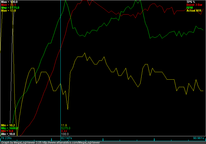

Ok got the AFPR dialed it for 55psi at idle without the reference vac line. The car is a PITA to get it not hunting again. Knew that was going to happen. But else then that the car is doing good. Although I am a tad lean with the boost AFRs mid 12's are a little scary to me. That needs adjusted a little as my car usually runs higher AFR with the cut out off at the track.
You can check the log if you want and let me know what you think. It just stoped raining when I did this so the had to ease into the throttle and still spun the tires a bit causeing me to not build boost as much. But you can see the injec DC is about 10-15% less then before.
EDIT: I tuned again, and else then my AE mode needing tuned how does this log file look, tuner guru's?? Is it ok? Felt good, car ran strong. The file attatched is the latest one. Im done for the day, but just wanted some insite.

To rough in the AE as it was before, multiply the delta MAP AE PW table and the delta TPS% PW table by the ratio of the old injector flow by the current injector flow. So, at 55 psi a 29 #/hr injector flows about 32.6 #/hr:
29 / 32.6 = 0.89
So multiply all entries in the two tables by 0.89
Did you update the injector compensation values in the calibration? Since you are using GN injectors I'd grab the values from a GN calibration and plug them in. Even though they won't be exactly correct at 55 psi fuel pressure, it should help with the idle.
RBob.
29 / 32.6 = 0.89
RBob.

Im not sure what you mean by calibration values? I modified the injector constant(f28 table) so that the car would not need to be tuned so much to compinsate for the increase in fuel. Although I got the car to idle and run well, under boost needed more tuning to dial in correct Afr's.
Fuel Injector Offset -vs- Battery Voltage (F92)
Fuel Injector Offset -vs- Base Pulse Width (F94)
Gimme' a few minutes to grab the values from a GN calibration.
RBob.

F92 Does have values, all 518.81 when the battery voltage is correct.

Leave the F94 table as all zeros, that is OK. See the image for the F92 values, much different.

What do you think? This is with only the new wastegate spring. Street start, street tires, cut out is NOT open. Car felt good and solid through out the run.
The Afrs are ok, a little shaky but they will lean out with the cut out off then Ill have to fine tune and continue to work on the AE some more.
Im planning on going to the drag strip tonight to run stock, so no cut out and no slicks. But if that datalogg is any factor of what Ill run tonight I would think low 14's are possible even with a slower launch. 0-100mph=roughly 13.15 seconds. So well see if that holds up tonight.
Sure wish I could figure out whats causing that false KR as I know its not real and its costing me HP at the track. If I even slightly squeel the tires the KR stays with me for a bit and when I shift and the car torqs, the KR is there. Some times the KR is there and other times its not.... Driving me crazy what is rattling or loose.

that spring works really nice, no more boost drop on the shift, need to work on the spoolup time as u should have no problems seeing full boost in first gear
im still trying to figure out why its lean in second gear but rich as all hell in 3rd
couldnt see the kr since it wasnt included in the log
and the spring made exactly what i figured it would 12/12.5 psi even though it said 15 psi spring

Heres the latest, since I couldnt test and tune at the track because of the rain I got out early this morning and tried another tune. The AFR's are ok, a tad rich but I wanted mid 11's as the cut out will raise the AFR at the track. That innoying KR is still there and Ive noticed that when im deaccelerating that the KR will pop up. But overall the car ran good and pulled strong for a street start. Enjoy the vid, and check the log if ya want. Ive taken so much fuel out of the AE mode and havent even moved the AFR at all when going WOT, its still rich.
This will be the tune basically I will run tommorow at the track. Since its a point weekend I cant keep messing with the tune to make it faster as Im sure the taller slicks do slow me down compared to these street tires on this log. But I know its impossible to launch on the road above 1700rpm or so.

ae = acceleration enrichment , changine these values wont change ur afrs, think of it as say a pump shot on a carb, its a quick shot of fuel thats injected when u open the throttle so the motor dont bog

goto ur ve map and reduce the value in the ranges of 5500-6000 12-14 psi and pull a bit of fuel out id start with subtracting 5 from whatever values u have now
the same thing at the follwing values
7/8psi row
between 4500 rpms 6000 rpms remove about 3 from ur ve table
ur are going way to rich at low boost this is also hurting ur spool up time
add 3* of ignition timming from 0boost to 6 psi from 3000 to 5000 rpms
7/8psi row

OK dave, ill tune it and take it for a spin later tonight when its darker out so I dont pi$$ off the neighbors..lol
I will admit I like the new wategate spring, the shifts feel much more smooth as if the speed doesnt stop like it use to.
Edit: values are changed and I will load up a datalog later tonight.

yeah that spring is 100 times better 0 boost drop at all, now if we can just get u to build full boost in first gear u will be set.
pulling that tiny bit of fuel and adding that 3* should help it spool up a lil faster.
not to mention when u can actually launch with boost it will spool up faster to.
we need to get u to were u can make about 6-7 pounds on the line and u will be set

in that datalog u launched with .34 psi of boost when u went from part throttle to wot.
ur also running really rich still
just to give u an idea of how rich here is ur graph.
the yellow peak to the right of the blue line is 12.0 afr that afr line should be flat across the map for the most part
for 1-7 psi u can actually shoot for around 13.5 afr
and on the far left when u go from part throttle to wot u can se eu have way to much ae

right now ur very close u basically getting the motor to 0 vacum on the brake then as soon as ur go wot it startts to build boost. if u can get it to 3-4 psi on the footbrake the car will do 1.8 ish 60 fts

its running so slow cause of how rich it is, the car is 60"ing better cause u are just starting to get the motor into the onset of boost when u go wot. a true launch with boost would a few psi before u release the brake.
13Afr up tp 6psi
12.5Afr to 10psi
12Afr to 13psi
11.5Afr to higher then 13psi?

12.5 afr upto 13 psi
anything higher then that stay around 12.0 afr till u see what it does
just cause boost goes up dosent mean the afr has to go down for most ppl 12.5 afr is a very good place to be

nm on the picture i though i had a copy of my afr targets table on the laptop, it son my other one and my gf is on it playing a game atm
as far as moving on the line are u using the ebrake to help hold the car??
do u have rear disc or drum brakes?

Dave, you know how I added some timing the otherday in the lower boost levels? And I also added some in the 90kpa and higher cells. Wouldnt that slow my spooling down since most of the heat would be absorbed into the block and engine and not directed into the exhaust. The reason I think that is because since the fuel is burnt at a later time(retarded timing) then the more heat would make it into the exhaust to spool up the turbo?
I have rear drum.
even with the e-brake, once I hold it at 2800rpms to long(over a few seconds at most) the car starts to spool as I can feel it and then the brakes get soft. I didnt link it but one time I launched at 3000 rpms and literly was moving slowly but managed not to red light
I have rear drum.

with an auto u want it lean and lots of timing to spool against the converter
with a stick u make it rich and severly retard the timing
that being said i can do the same thing i do with stick cars with an auto, but well work on that later first we need to fix ur afrs.
also if i show u how to set it up like a stick so it spools up super fast u wont be able to street drive on that tune so u would have to keep that tune on a seperate prom for the track only
I dont understand why it would matter if it was a stick or auto when it comes to helping up spool time for drag racing. Just retard the timing and add fuel and leave it on one bin file. Then once x psi is made then go back to the leaner(13-11.5) Afrs? But Im not thinking that this route would not be good for the exhaust valves and such?
I can tune tonight but tommorow I am going to, I already played with the bin file and modded it for a few chips so I hope I get results. I can get those AFRs under control in a good hour of tuning.

the reason u dont go super rich and retard the timing with an auto well theres 2 actually
witht he timing that retarded it will never flash the converter to stall speed engine wont make enough tq to push the converter
#2 with the motor being that rich the car will bog when u go wot
with a stick there is no converter to load
the only way to setup an auto car like that and have it work right is to use a 2 step or antilag/launch feature

Ahh I see, theres a spool up mode on $59 but its undevelpoed I think as I tried it once and It didnt work right, actually it ruined a bin file so that it wouldnt read anymore...
