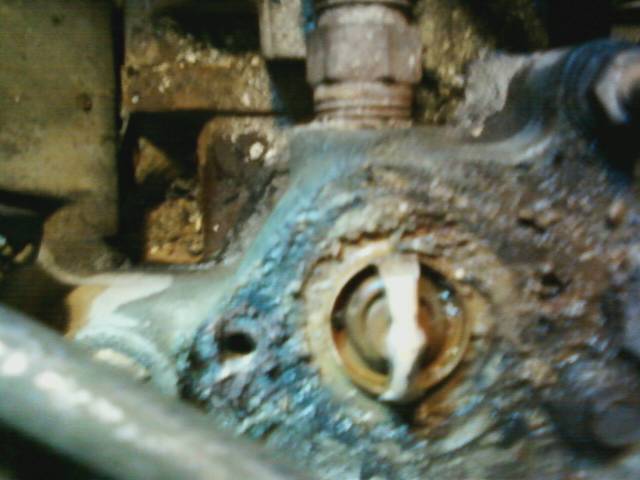

Coolant leak, need to replace gaskets to fix. What is the name of this part (pics).
I have a coolant leak, it was leaking under that pipe in that picture, i took it off and there seems to be some sort of gasket or seal that helps seal the pipe to then engine. Its the pipe that connects to a hose that leads to the radiator. Also is there a gasket that that goes on the intake manifold cover. When i took it off there was no gasket but it did seem like there was a little bit of silicone or something on both the intake and the pipe but no gasket. Is that what i need to buy to make sure the parts seal well and there is no leak? What is the name of the silicone and the name of the pipe. Thanks for the help

thats a thermostat. and it looks nasty. replace it, and clean the sealing surfaces (intake and water neck) with a mild abrasive sanding disc. get new waterneck/thermostat gasket and coat the gasket with silicone by tacking it in your hands. dont use a bead on it (gets too messy,and just too much)

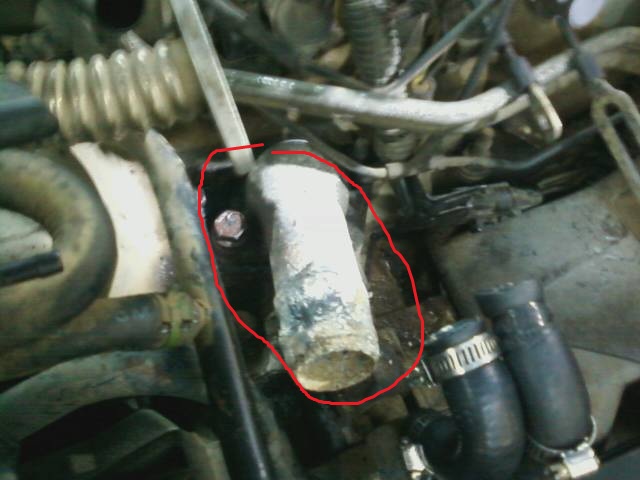

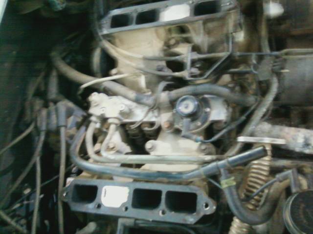

First pic is where I think i need a gasket on the intake manifold cover.
Second is the pipe i removed
Third is this little piece thats hidden under the pipe. Im not sure if it has to do with my coolant leak.

I got the the water outlet thermostat and gasket but still ne the one for the intake. What exactly would it be called? Heres a pic of where it goes.

upper plenum gaskets.

U can use goop on the plenium ones

I can't find a new thermostat housing (that pipe where the thermostat goes) for my 2.8, they're all for a v8. Will it matter if I use that one, i dont see how it would hurt the car or why the part wouldnt work.

I found one for an IROC but it has two holes that look like there supposed to have bolts go through it. Does anyone here with an IROC know what the deal is with those holes? Here's what im talking about.

why dont you reuse the factory thermostat housing?

just put a pipe plug in those holes, they are regular NPT pipe thread, take it to the plumbing section of the HW store.

I own an 87 IROC that used to have a 350 TPI and the thermostat housing shouldn't have an holes in it because it sits almost under the throttle body and there isn't any room to put sensors in it. All the Coolant Sensors for the IROC-Z are located in the heads and on the bottom front of the intake.
You can use NPT plugs from a hardware store to plug them, just make sure you use pipe dope or Thread Sealant Tape when installing the plugs.

Originally Posted by xMrBadDogx
Hmm, i dont know what was up with those housings then. It almost looks like it was just a little window so u can see ur coolant but im not sure. Anyways O' Reilly's hooked it up and i was able to just order it there. I didnt reuse my old housing because it was just that rusted. Last time i had a piece of metal that rusty it broke off and it was so difficult to get to the housing i dont want to have to replace anything near there for a long time.
Those hole, on that thermostat housing are for the old "Ported Vacuum" switches, that GM used on the carbureted engines. My 1980 Chevy Malibu had them, and it was a smallblock V8. I tried pipe plugs, and even with thread sealer, they still leaked. So Junk that and get one with no holes, if you can.

ok, i finished assembling everything but ran into 2 problems. I broke a little plastic hose (it was very brittle) and also dont know where this senor goes. Do i really need to replace that tiny little hose? There seems to be a dozen useless hoses on the 2.8s. I'm probably gonna have to take a bunch stuff apart again but i need to move the car somewhere they'll let me work on the car and to give my mom back her parking space.

Um are these crucial to the engine? my car wont start and i need to move it :/ Its a little plastic hose that broke off

Yea they are. There vaccum references
Would that cause my car to die as soon as i start it? And where could i get another one.
try looking on ebay. I have a spare one if you can find one. Let me know ill ship it out too ya for next to nothing. Just give me a day or 2 if possible. Alot of working in the next few days.

That would be great but if they're vacuum lines could i just plug up the hose? Also would that cause my car to die as soon as it starts? It just starts, redlines, and dies Im assuming its a sensor i didnt plug in or something but idk if it could be the vacuum line. And u have the little hose? I need the one thats to the left (when facing the car from the front).

There are three lines coming off that vac reference port area. The major one is the fuel pressure regulator. You cant just plug it, or it will rich at idle.
If all else fails just take those lines that went to that spot originally and run them to the back of the intake. There are more ports back there. One is for the brake booster, another for the map sensor, and another one that I cant remember what its for. I dont have any emmisions on my car so I forgot what some of those lines are for.
But if you just get somr fittings and some vaccum hose, you can make it work pretty easy.
plus sould do the trick. Just be creative, its not rocket science.

ok thanks, ill probably get the fittings and hoses just cuz mine are so fragile. Thanks for the help.
