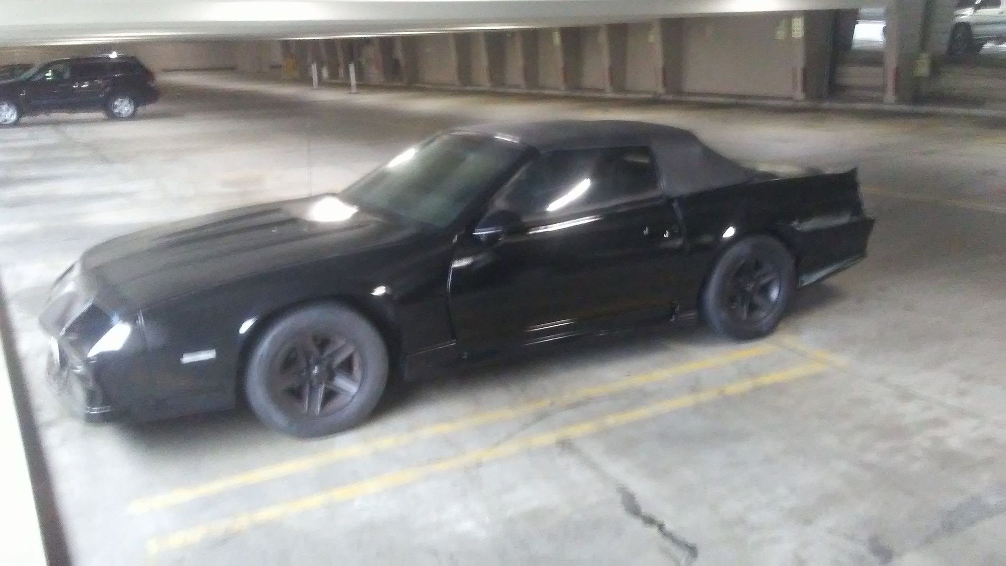

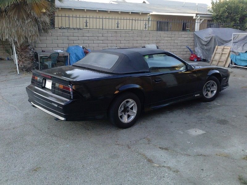

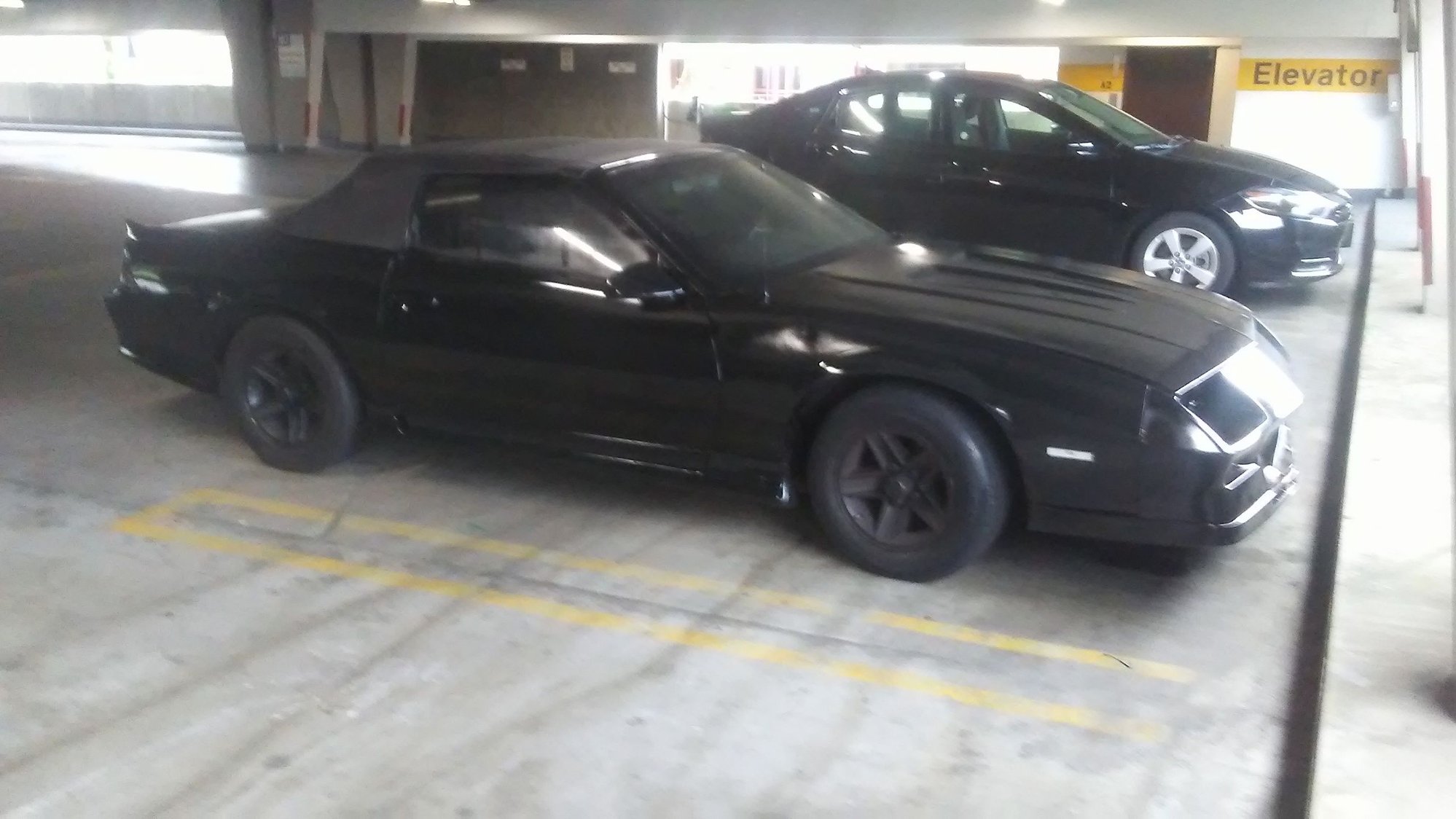

Recently painted it back to black. Got the paint for 25 and thinner for another 20 and borrowed a friends compressor and painted it in less then 4 hours . Not a great job but looks alright since I am on a low low low budget. Wish I could go back in time when I first bought it and it was pretty much all stock and flawless, body all original. A while back some idiot ran in front of me at the last second and destroyed my front end originality. He didn't have insurance so I had to take him to small claims. Had a 84 z28 for parts and I took the front end to replace mine. Really bummed out cause the hit caused my fenders and hood not to line up properly but hey. Original motor still going strong with over 250xxx
miles.

Looks good Maroe, wish I knew someone that could blow over my car like that !

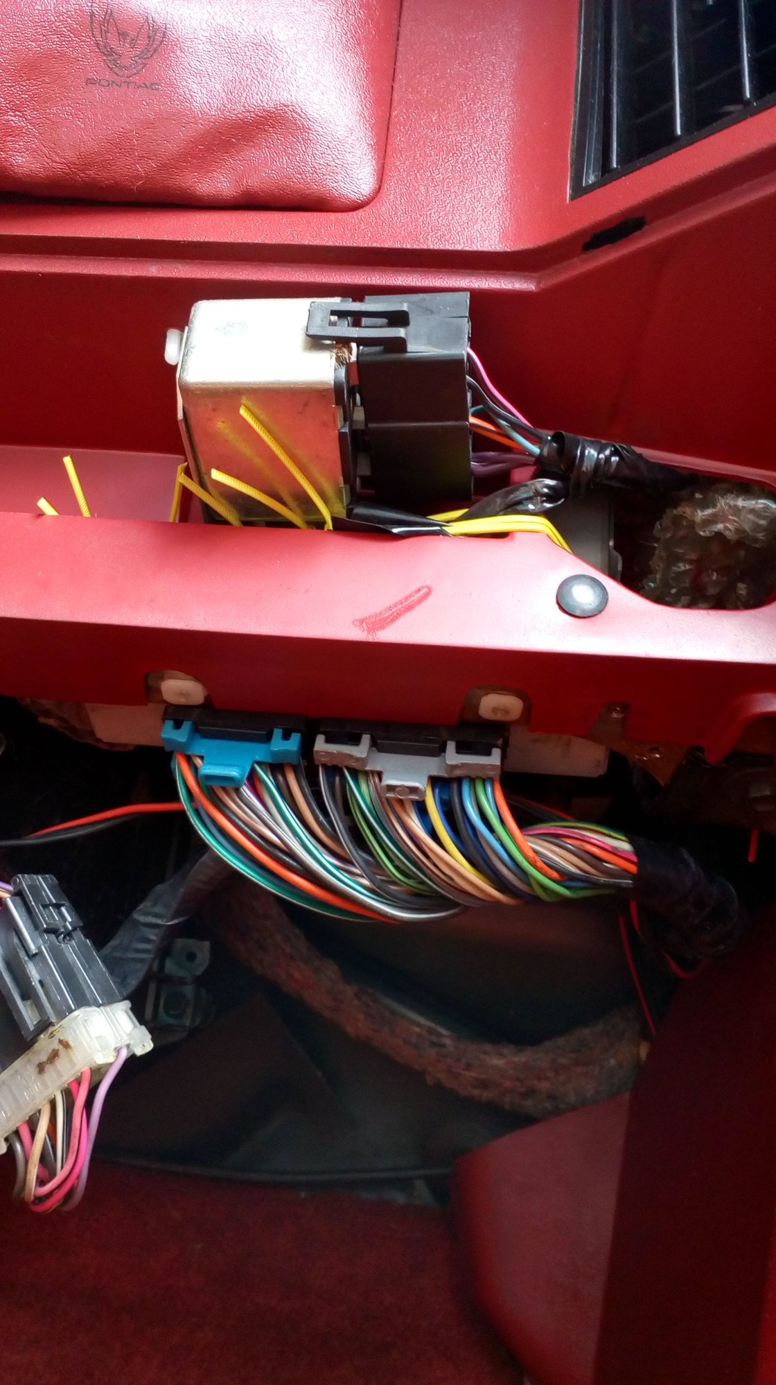

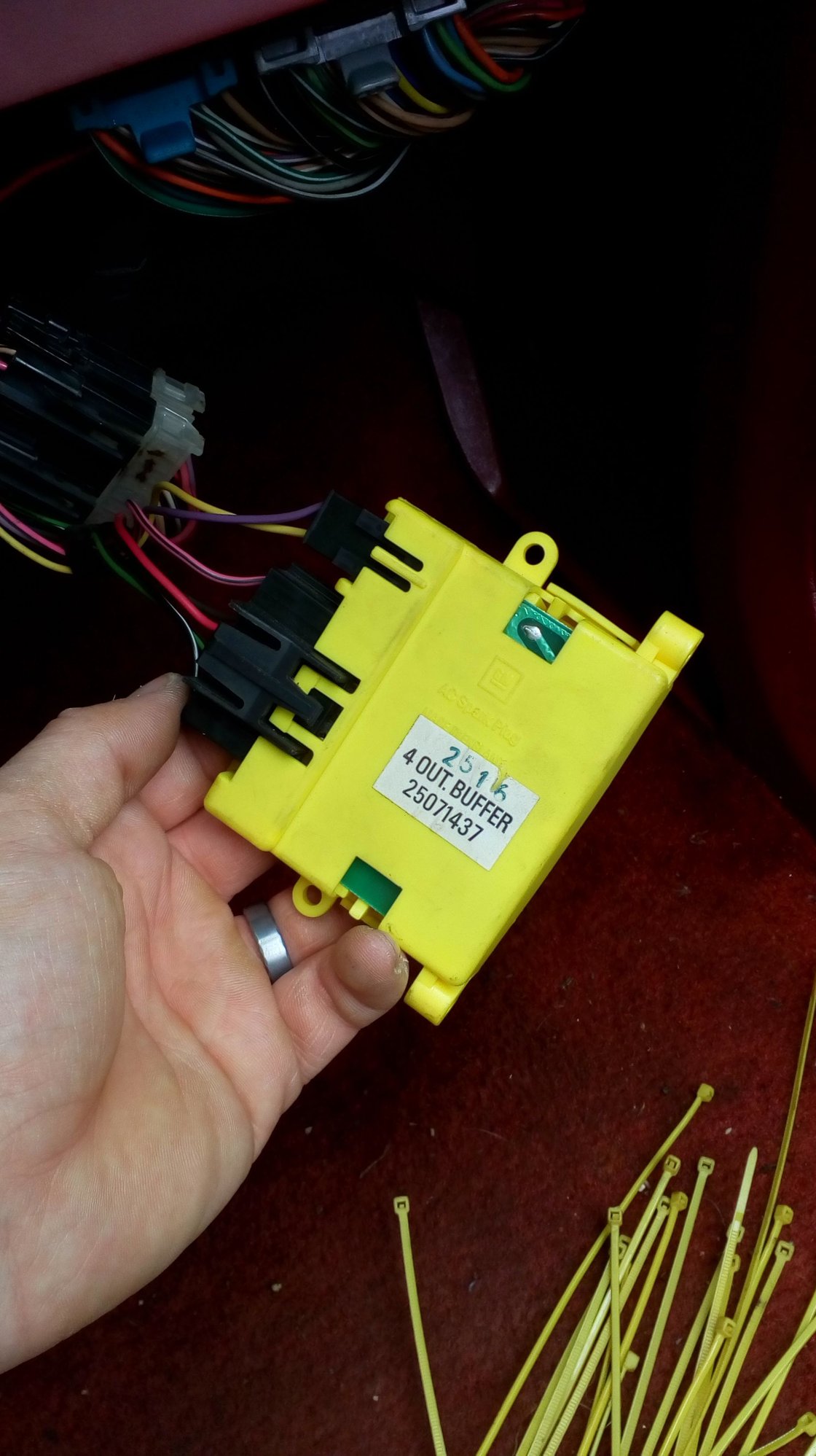

So I know the guy before me had this thing in pieces, stuff doesn't work, horrid wiring connections, random wires, all that sorta thing. Well the computer has never actually been secured properly and I've never really looked at it. Well today I took it all out had a good look around and secured it how I saw fit, it isn't flapping around anymore and now I know what's going on under there. Whilst I'm there does anyone know what this yellow box is and this little metal box still on the passenger side dash..... Wondered what this is?
And this little metal box on the front of the dash.
Various zip ties now mean the computer is not flapping around, it is sitting on the ledge on some things foam padding.

Yellow box is vss buffer box for speedometer (thanks for posting know I know where it's at). That cube thing, if I'm correct and it's heavy, is a "discrimination" sensor for the air bag system. Looks like the one below the center console.

Thanks cheerio. I dont know how heavy the silver metal box is, thats exactly where it was attached , i havnt moved it. My car did not have airbags though.
that yellow vss box was just dangling next to the ecm.

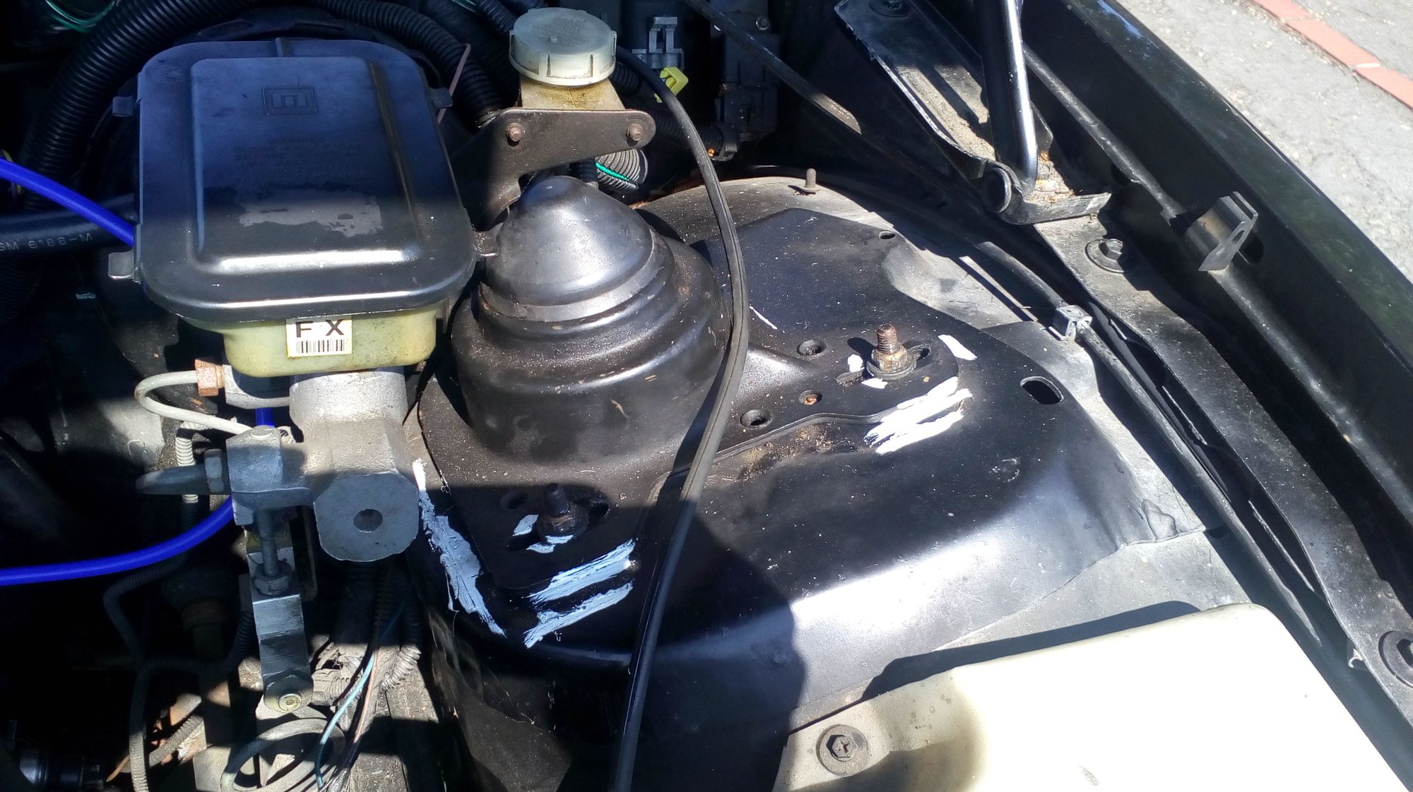

You've been busy cheerio ! I've hoovered my car out, which is silly really beacuse next week it's doing a 500 mile camping trip with two muddy mountain bikes stashed in side, oh well it's clean for this week.
ive been doing some suspension tweeks , adjusted camber and Castor on drivers and Castor on passengers. Panhard rod is in the shed being cut and welded up a little longer to center the axle.
Lots of marking up.

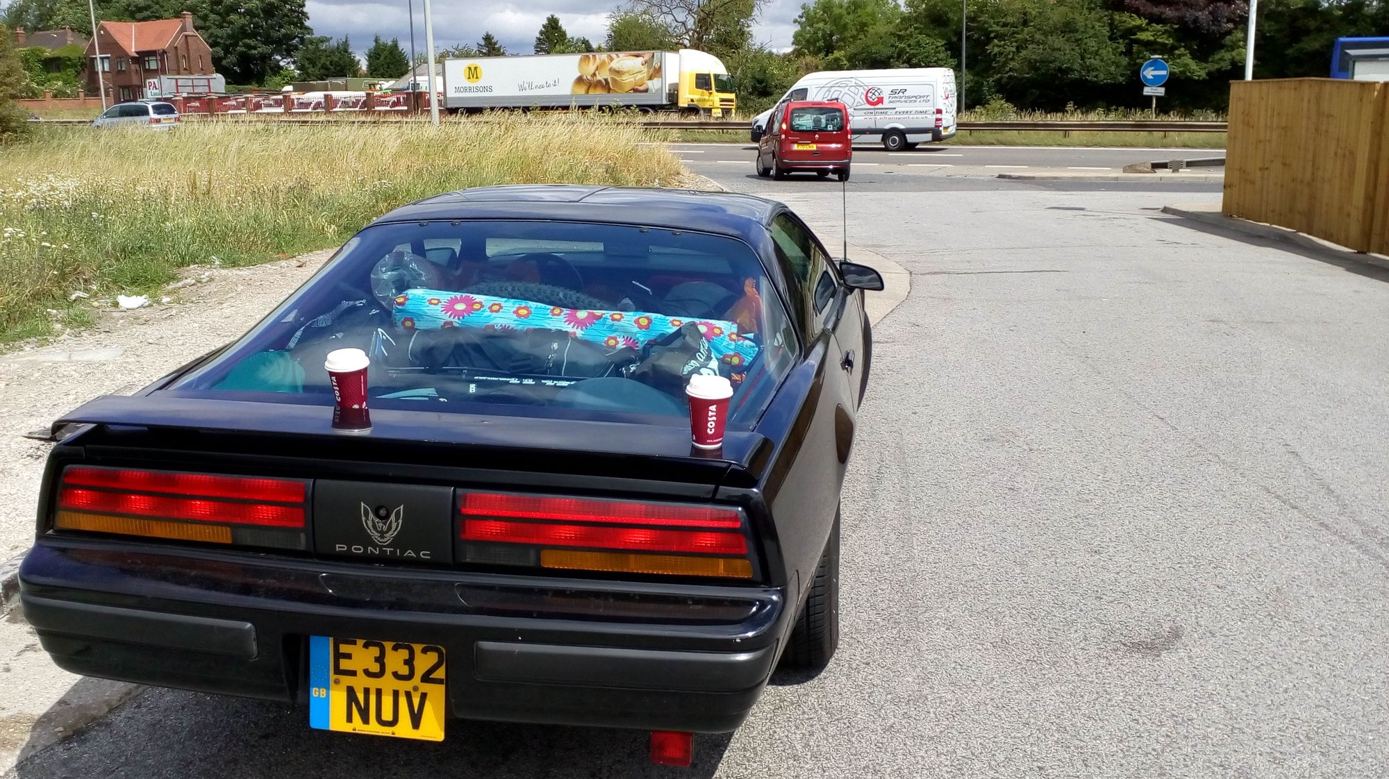

Rear shelf was handy for roadtrip coffee......

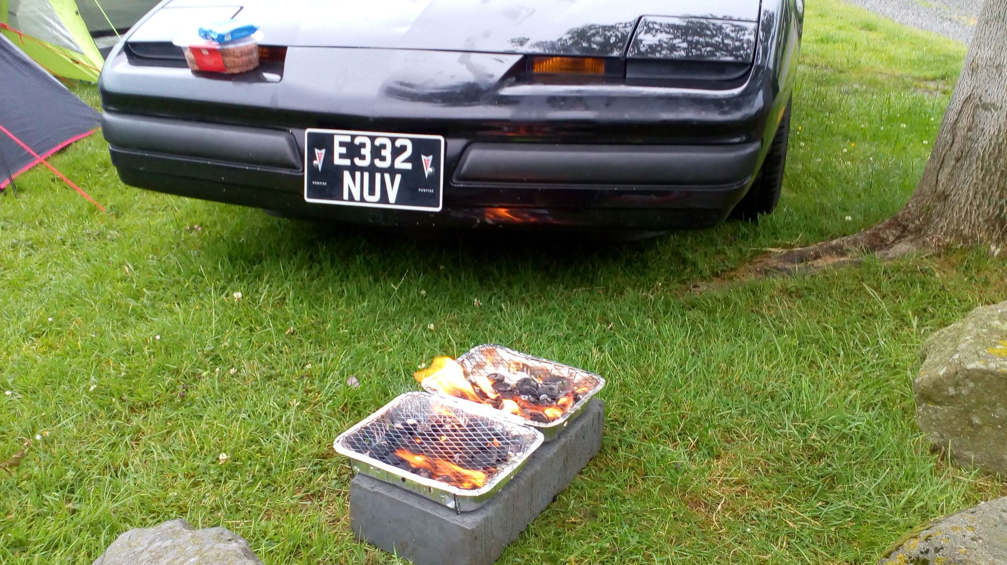

Front shelf was used for BBQ burgers and later, sauces and whiskey.

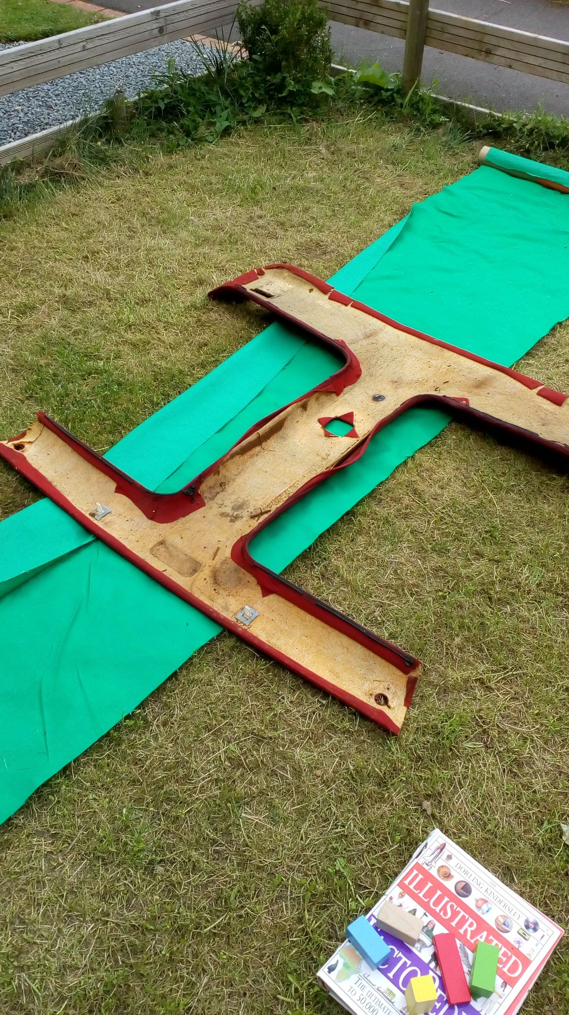

It's disintegrating

lol, I think yours looks better than mine, it's on my list but I have to get mine running first.

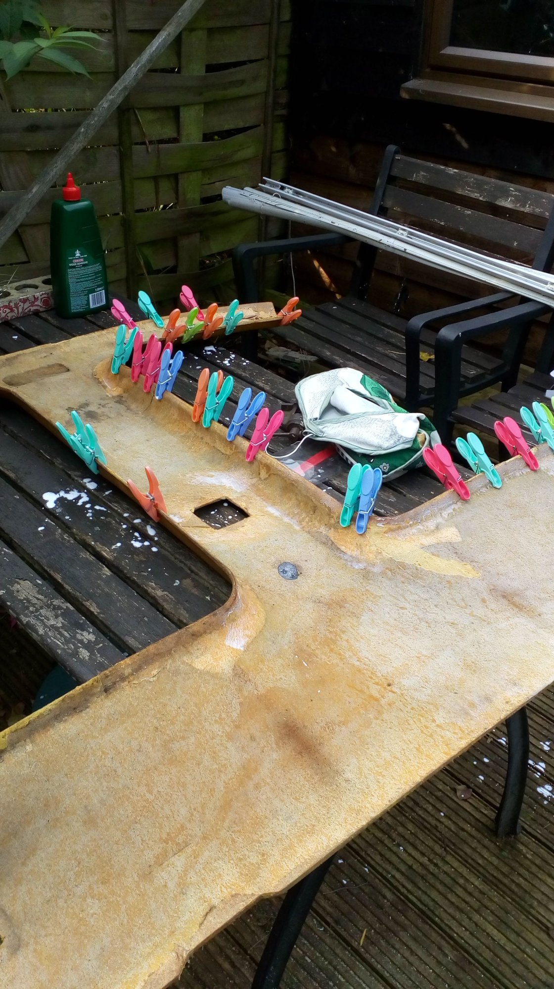

Found some time to water down some wood glue and soak the headliner in it , using clothes pegs to hold the edge layers back together. Figure itl take a few goes but it should be nice and solid once done.
