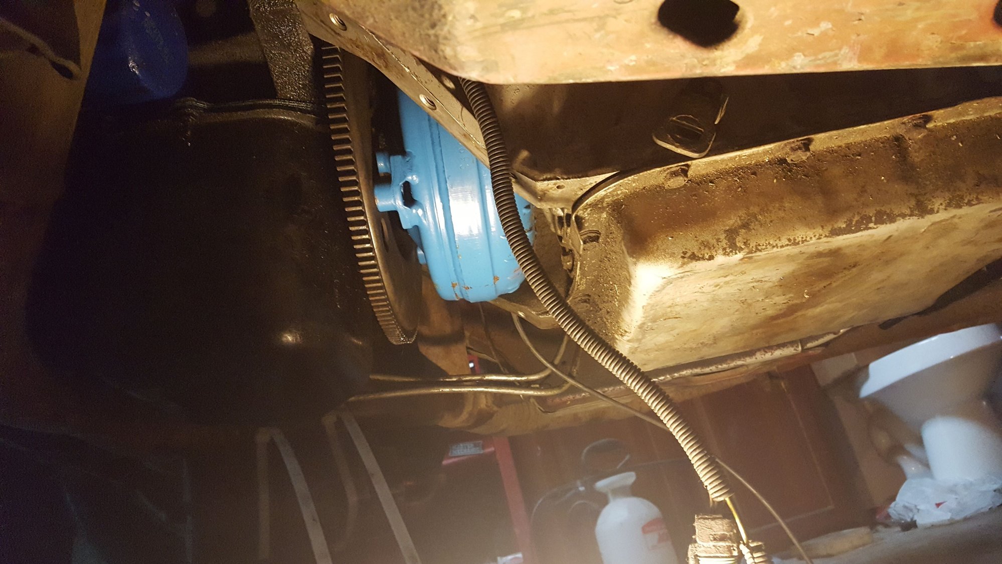

So, not what i did today but the last week. I finally installed the S-15 trans in the firebird after 9 months. Drove it 2 1/2 states (365) miles home and all is back to normal so far so good. Now i have to go replace the thermostat.
Let the fun begin!
New torque converter !
S-15 trans 40k miles changed tail housing, detent cable and mount.
Installed!!

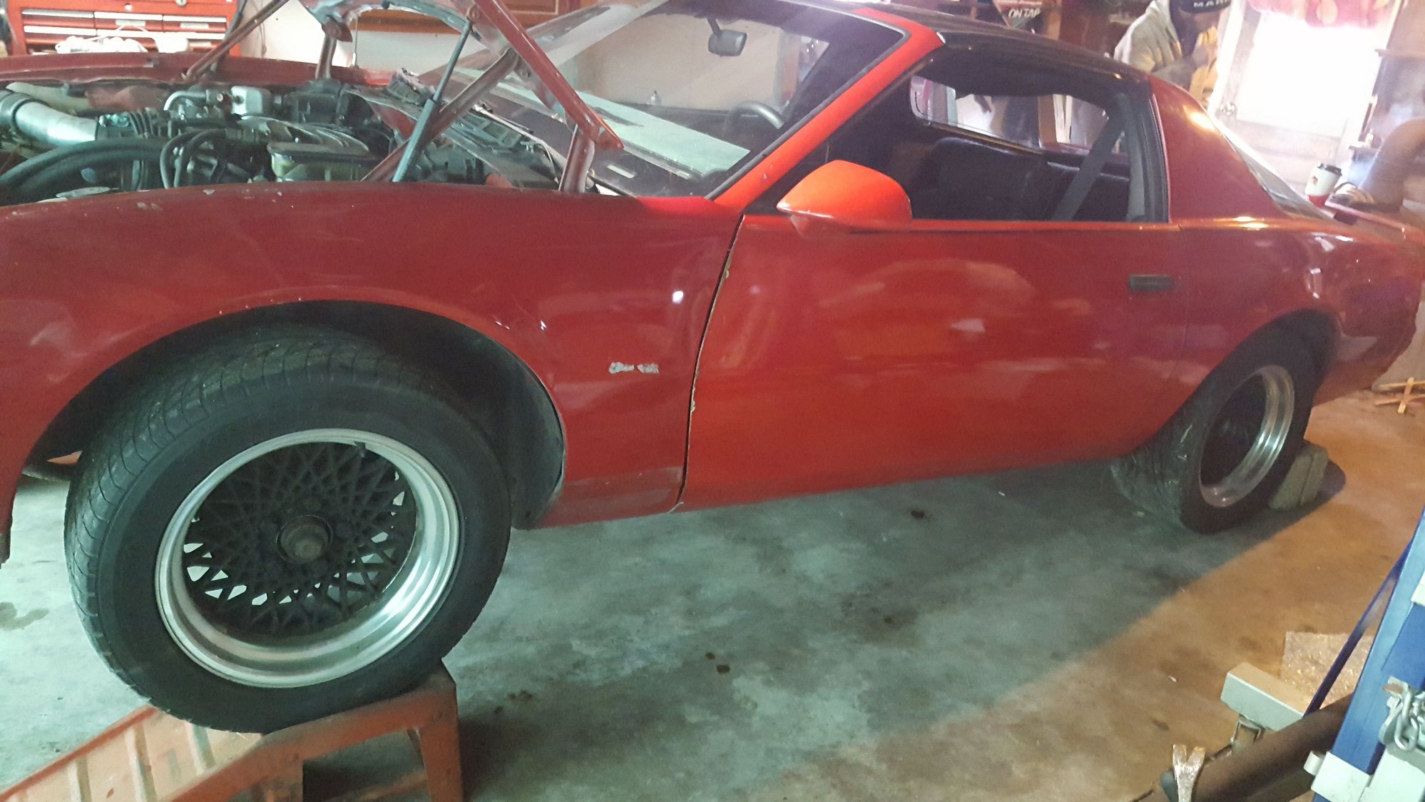

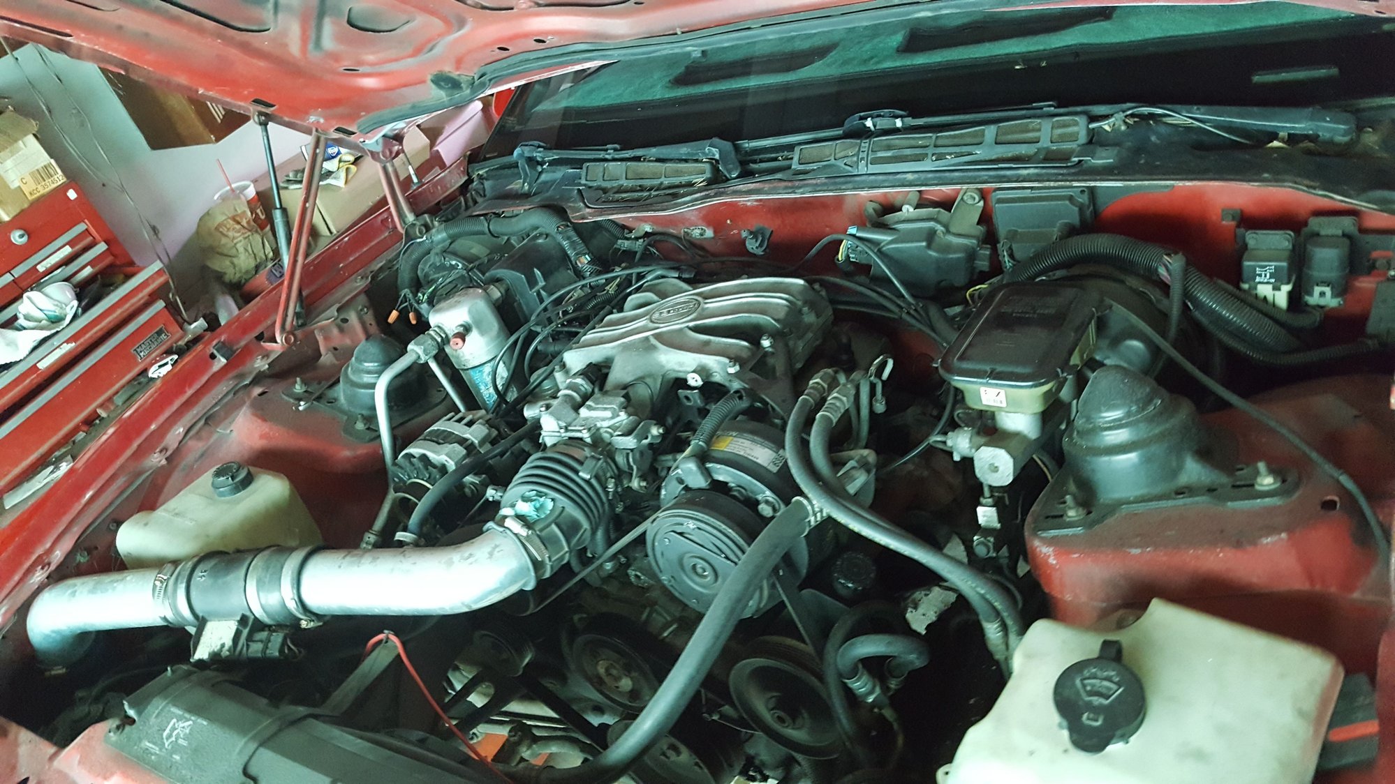

Bought this gem about a week ago, couldn't refuse the price + it has a electronic dash! Finished putting in the tranny, reverse let go.
Not a fun job replacing the tranny on the floor -_-'
Few more things to do b4 its road worthy but I'll get there soon. 88 bird
