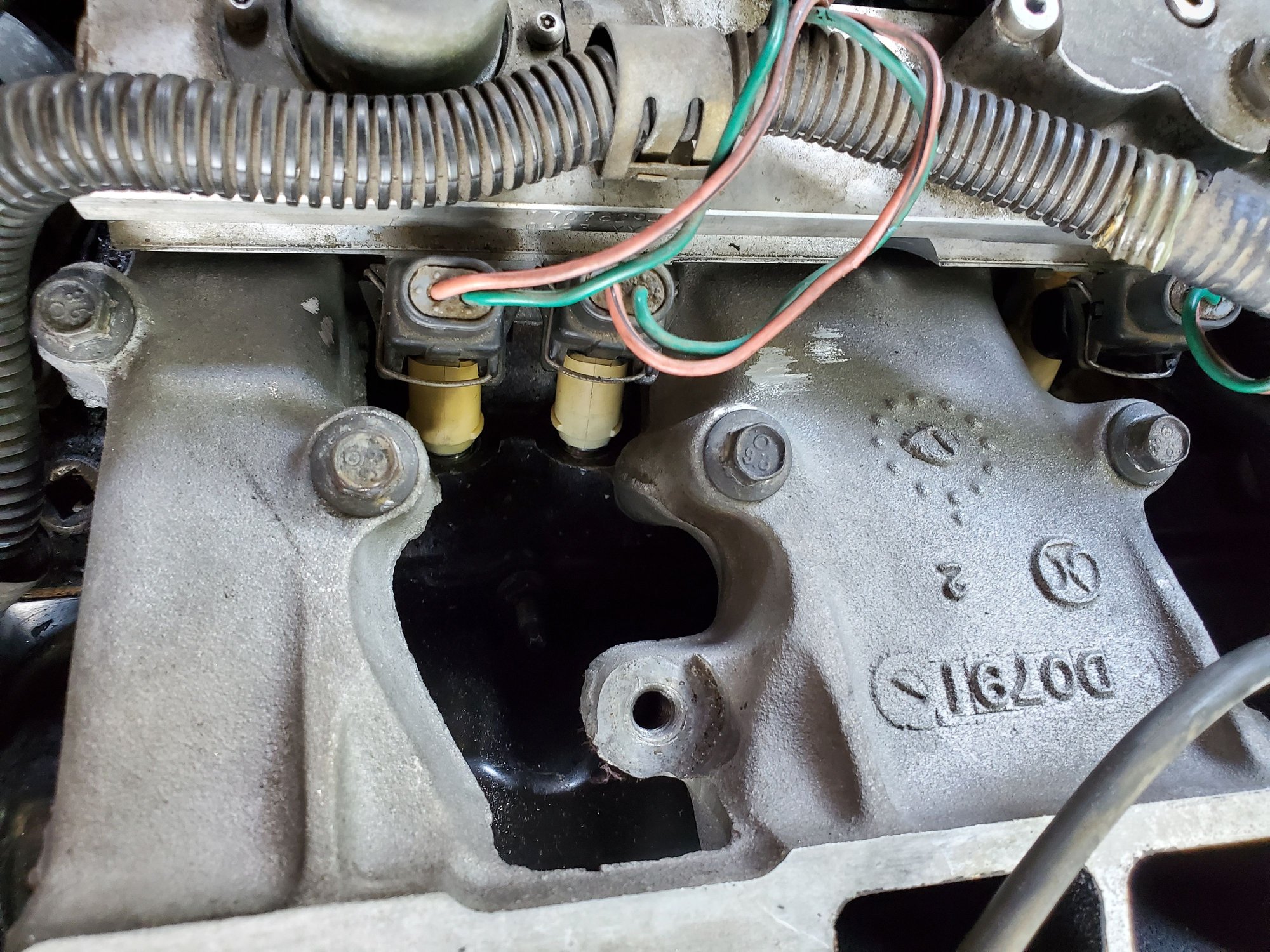

I just installed a set of 0280155703 injectors in my 3.1 after getting a bad set of factory ones from a supposed rebuilder out of Cali. (I know better but I didn't check with Southbay as I did this before even going on TGO)
They are rated at 16lbs/hr so they are slightly bigger but so far are working good. These were originally used in Dodge 2.0/2.4 engines
Should also mention I did look at some factory Denso ones that are rated at 15lbs PN# YL8E-C2B but would require a EV6 to EV1 adapter for an additional $10

I decided to try the Denso injectors using the adapters just to see how they compared
and these things work great! left the tune stock with these injectors. The previous bosch injectors were running just a tad rich but nothing I would complain about. these show a noticed improvement over those though. just another option to the old injectors
