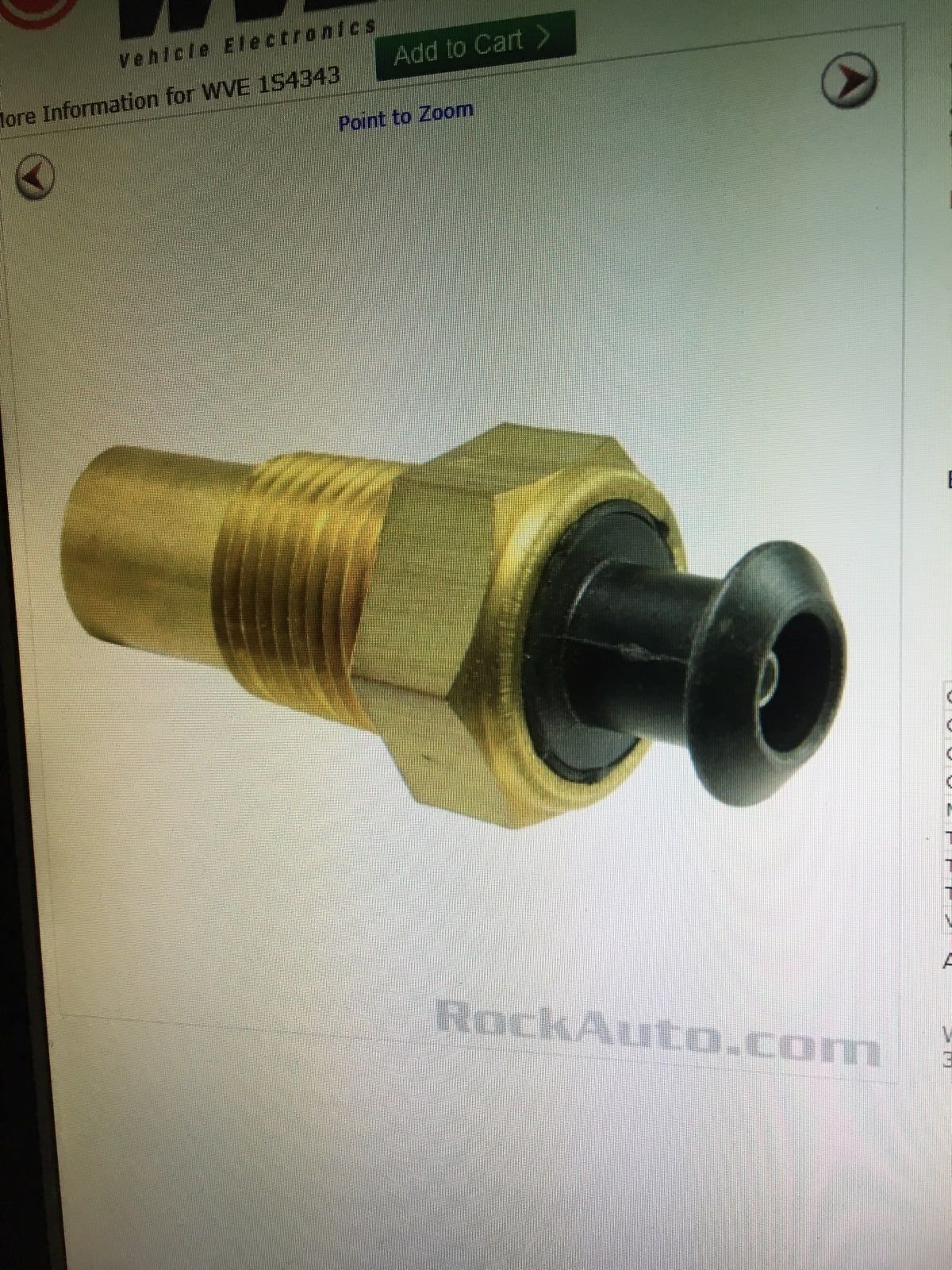

Sometimes life gets in the way of a quick answer , this past week I was tied up with a set of Ford 4.6 timing chains
Now , what your looking at is not supposed to have any vacuum hoses connected to it , it's (what's left of) the radiator's fan switch that is supposed to engage the fan if the ECM doesn't . I say "what's left of" because the metal pin you see in your pic is actually the electrical contact in the center of the nice new switch in this pic I stole from Rock Auto of what your switch is supposed to look like if the plastic wasn't all smashed off of it .
There should be a wire hanging around somewhere in the general area with a connector that'll fit over what you see in my picture ........

Good job orange. The connector end will look something similar to what the connector on the brake valve under the booster looks like. Should have a green or green/white trace wire to it.
