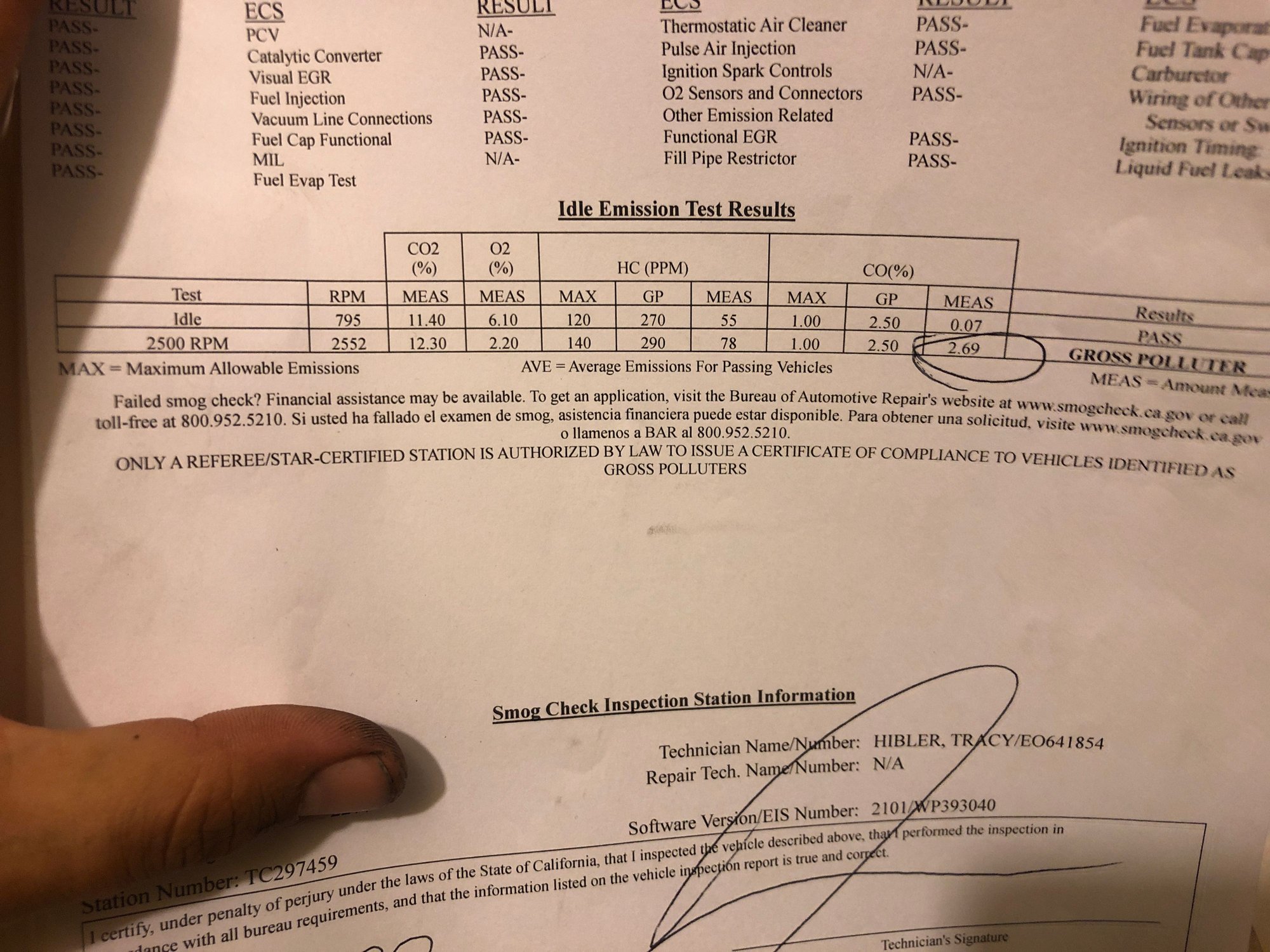

Ok so I’ll upload pics of report so I decided to comb over system,new 02 sensor I check fuel pressure and it’s right at 43 psi like spec,and decide to check and test injectors,when I pull injectors to test,and right away I noticed whoever owned it last swapped 2 of the 6 oem injectors with two triple flow and left the rest oem,so I’m assuming haveing two high performance higher pressure injectors and the rest oem would throw off everything,I’m just spitballing
Smog results

Re: Failed smog gross polluter
I think you’re on to something — your CO was too high. Carbon monoxide is the result of running really rich, incomplete combustion. The fuel mixture might be off.
