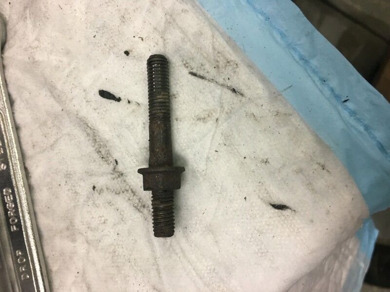

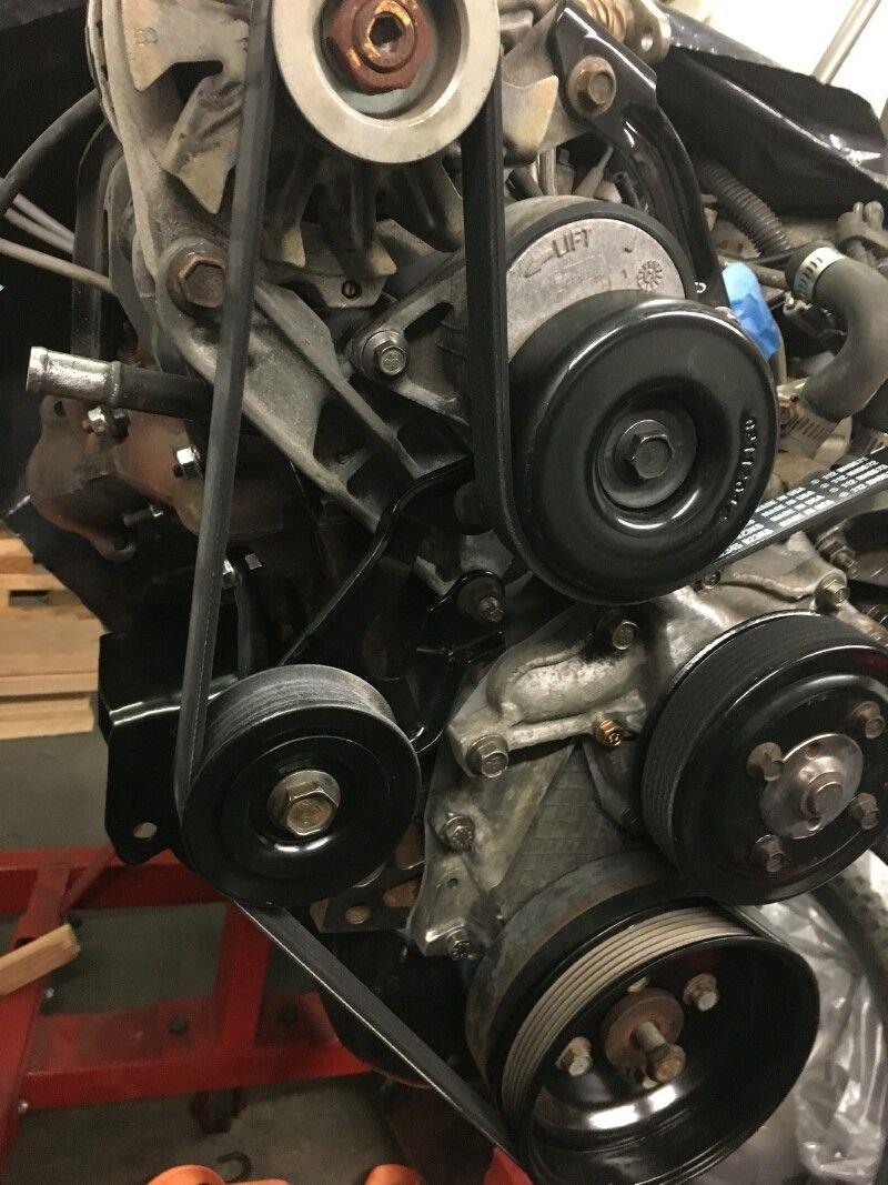

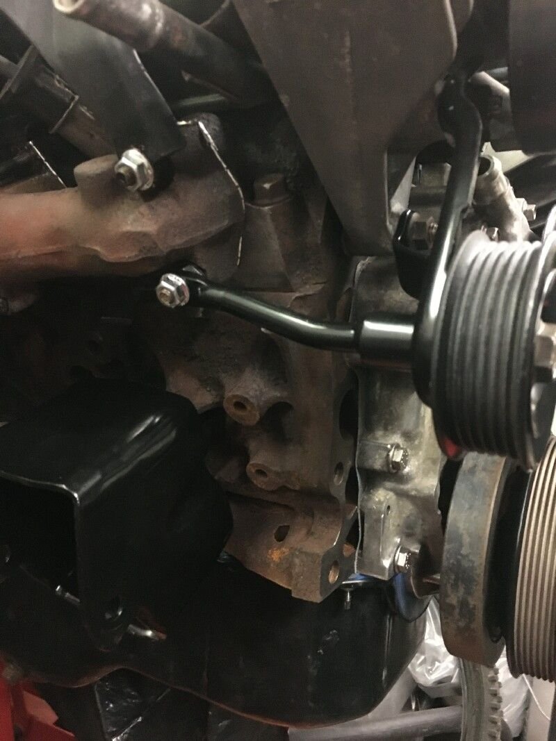

End Result: I have assembled everything so here are the pictures. I haven't run the engine yet.
Idler Pulley and Bracket from an 88 Camaro V6
Belt is the one for the 88 Camaro V6 without smog pump (92.3 inches and fits perfectly)
Need to use a stud-bolt on the exhaust manifold to accommodate the rear bracket brace
