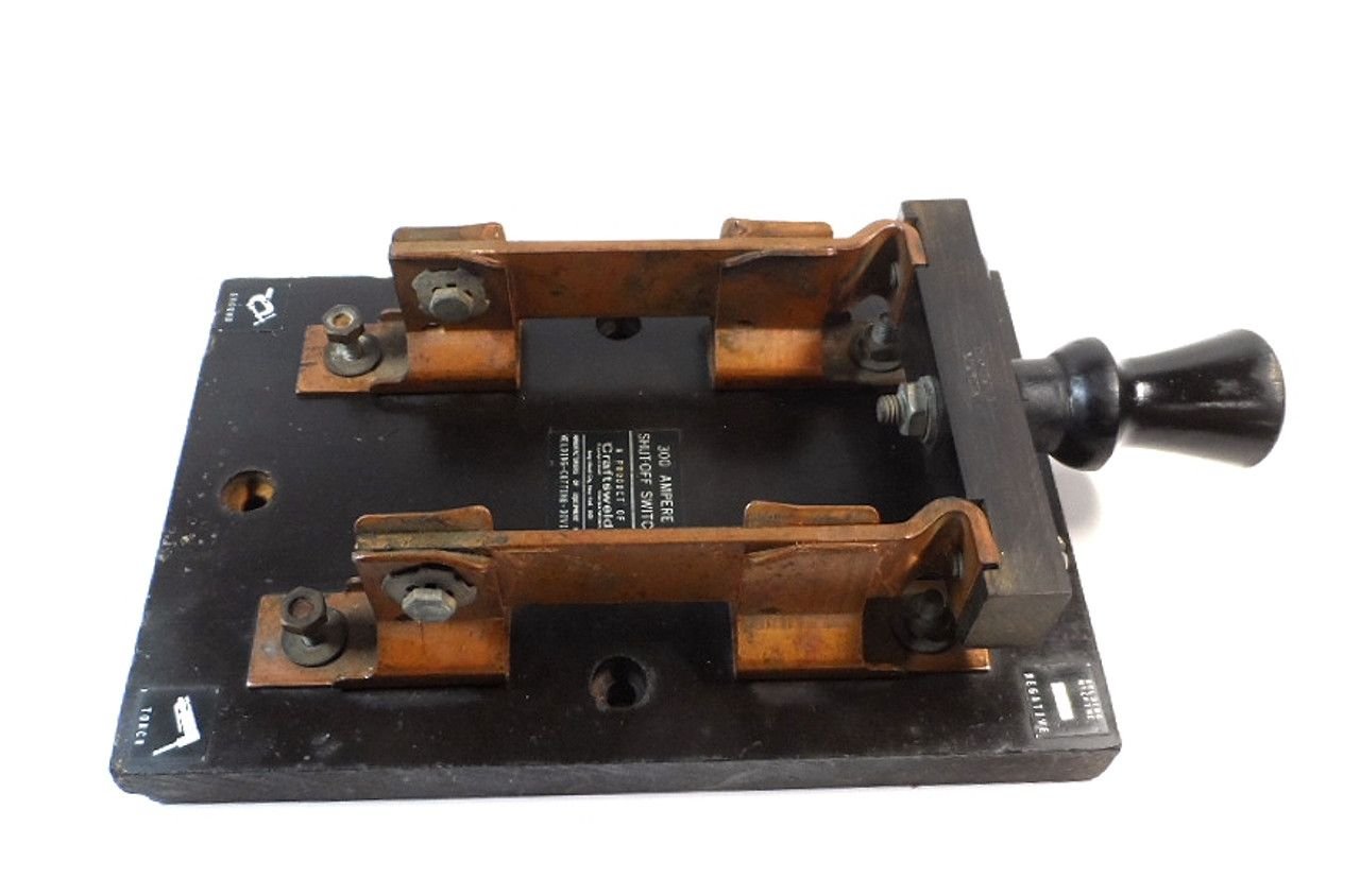

* Unless, of course, ya wanna go gettin all Frankenstein on it....
