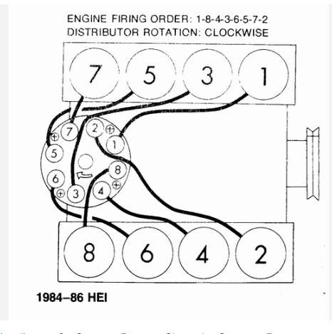

I CHANGED THE DISTRIBUTOR BUT I REMOVED ALL THE CABLES (I WAS A DUMB) I WANT TO KNOW HOW THE CABLES ARE CORRECTLY SINCE I DON'T MARK THE CABLES I REMOVE THE DISTRIBUTOR SINCE MY CAR WON'T START, OUT OF NOWHERE IT TURNED OFF AND I DIDN'T WANT TO. WHEN I REMOVED THE DISTRIBUTOR I PUT IT AT 0 DEGREES ON THE TOP ****ING DEAD, WITH THE ROTOR POINTING AT CYLINDER 1

Plug #1 faces the #1 cylinder then just wire up in order

Dang! The picture did not load when I made my previous comment, so I assumed it was a V-8 ! ...
