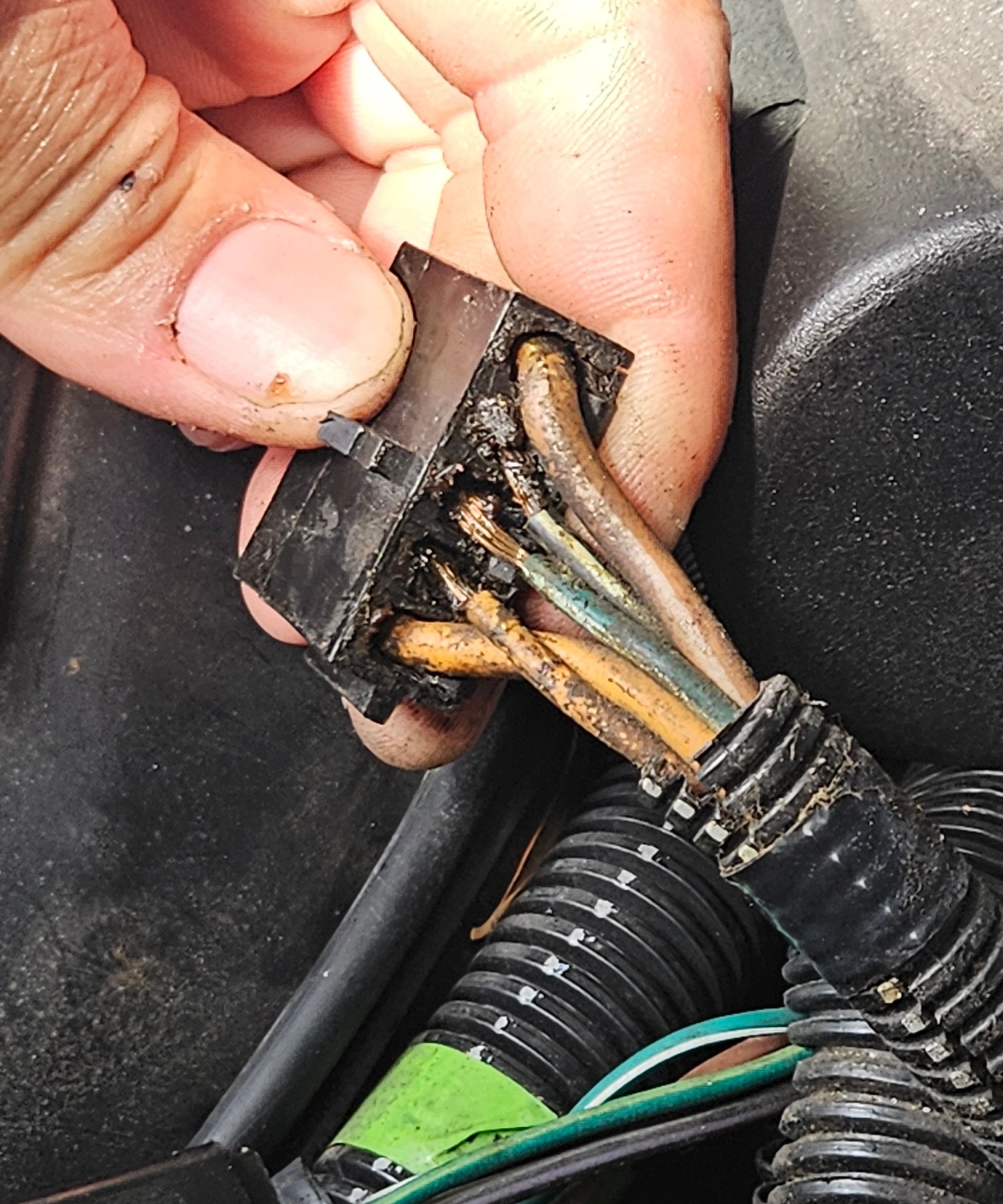

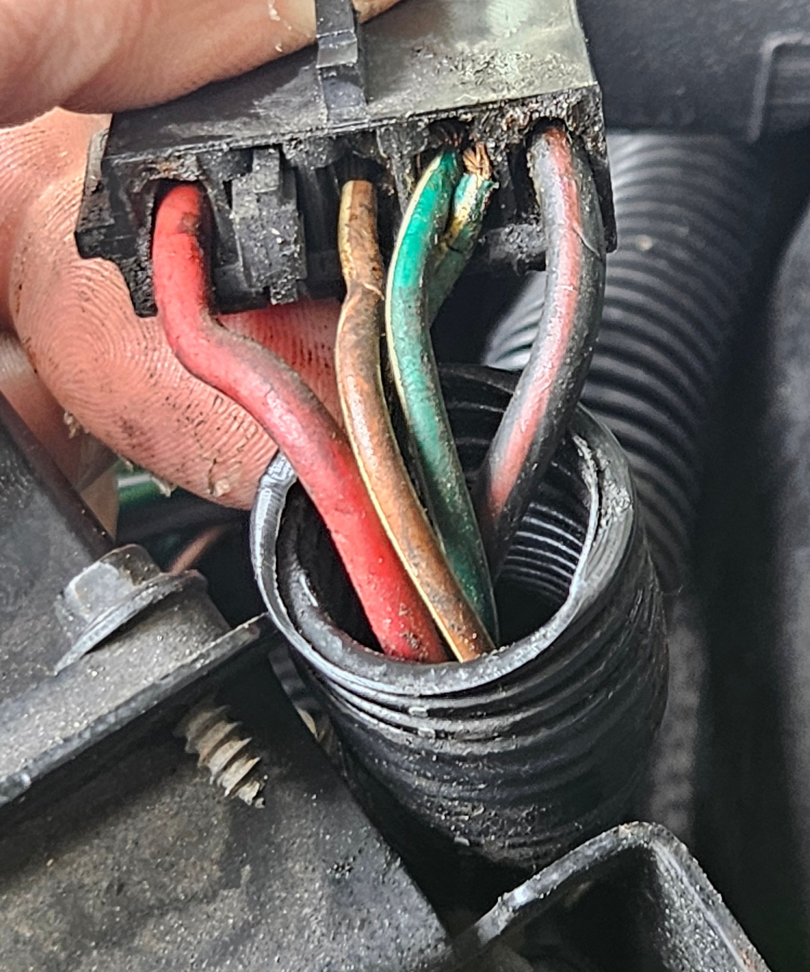

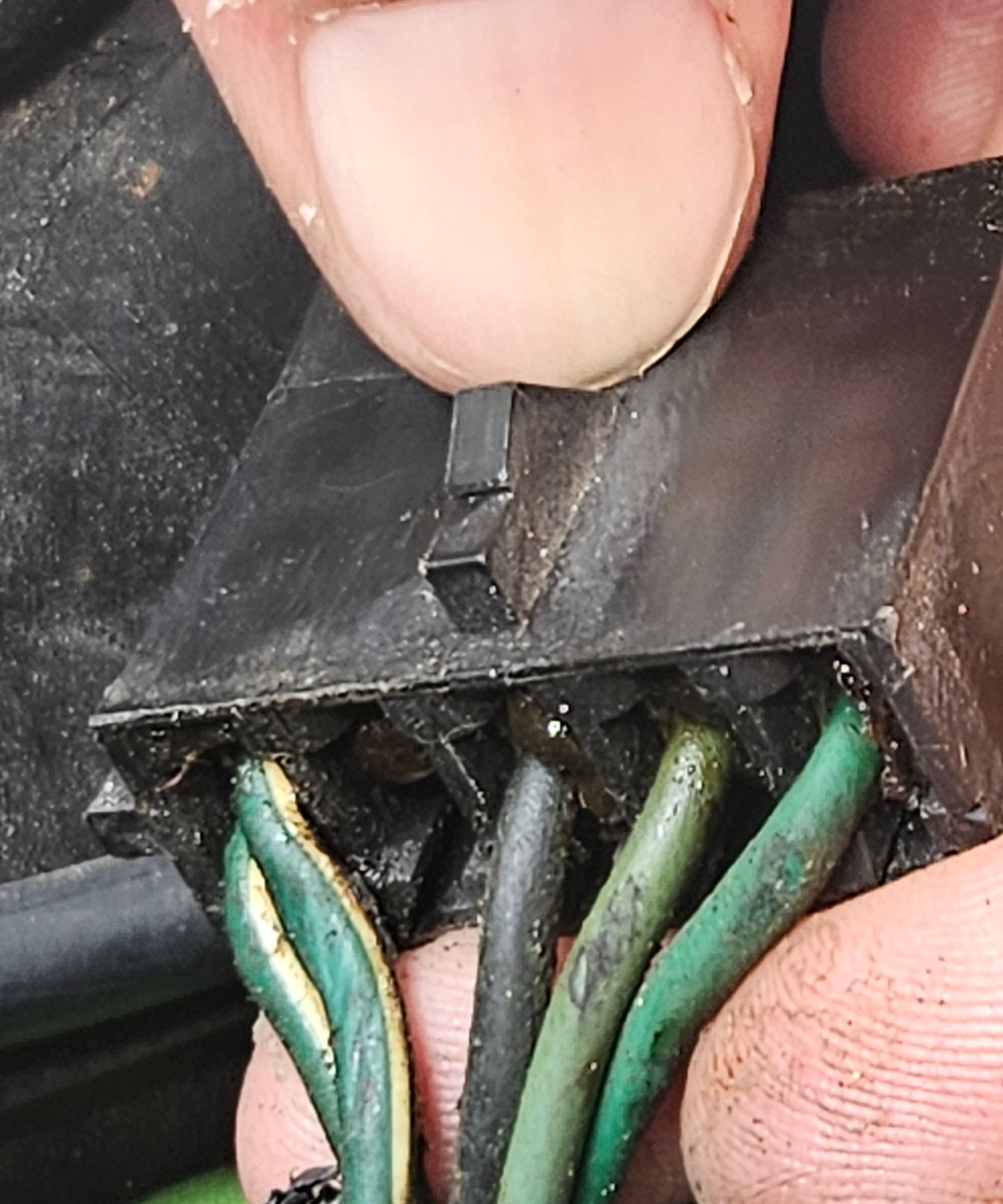

A/C Compressor Clutch Relay, FUEL Pump Relay & Engine Coolant Fan Relay and Ima Rewire All 3 Old Connectors Cause the wires are showing anything that looks old ima replace I've always done that to any old/classic car I ever had ?
Engine Coolant Fan Motor Relay Had To Replace It All
AC Compressor Cotrol Relay Had To Replace This All
Fuel Pump Relay I Had To Replace It All
