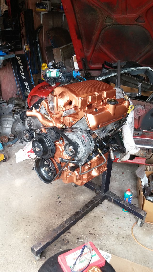

No, it is not plug and play, while the signals between the ECM and ICM are virtually identical, there is a 60 degree offset (unrelated to the engine bank angles, as other GM DIS systems of the time used 60 degrees along with 80 degrees for offset timing), in order for the ignition events to happen at the correct time. I don't recall which parameters had to be modified offhand, but there is information on this in the DIY PROM forum, I recall a thread that either I started or was involved in way back in the late 2000s (under my old user name "The_Raven") about this as that's where I got some of the information I needed to swap the setup that I put on my 3.2L (0.030" over 3.1), to my Datsun 2.8L (inline 6), and used a different MASK (code/bin/tune) than I did in my Jimmy back in the early 2000s where I used a stock ECM out of a Cavalier. I also used this setup briefly on my 3.5L V6 that I swapped into my Datsun (picture attached, I can't seem to locate pictures of the previous engines).
You can see the trigger wheel behind the crank pulley in the first picture and the Sensor bracket I used in the second. The sensor bracket was actually a bit different when it was in my Jimmy and was placed against the block, I loved it forward for a few reasons, but still the same end result. I only made it adjustable originally because it was before I got into tuning that it was originally made and wanted some adjustment to get the timing right. Now I would just make the sensor bracket fixed and adjust in the ECM for any mechanical inaccuracy of sensor placement.
