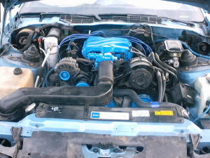

Well, I did a launch bringing the RPMs up, in 1, with my foot on the brake..as a test today.. It launched fine, no bog down, no tire chirps. I have more than enough traction as it stands right now...that car is heavy as hell. No subwoofers or anything extra added..it's all stock-weight. By the way..the rear shocks are new, and stiff as hell..is that good or bad? (the fronts are a little mushy, so the car has a front-down appearance) Ok, the air filter is only like a month and a half old...a K&N. Still looks brand new, except for a big black spot on it, where the air hits it. I just rotated the damned thing. And no, I don't own a timing gun..but I could easily buy one for like $40...if I had the spare 40. I'm getting a CD player and all new speakers put in the day before the event..so..kinda short. (And no, no subwoofers..biggest ones are 6x9's) Stock-type of stuff. Now, here's a dilemma. My car hangs in 1st, and in 1... Bad....my tachometer is WAY off (says I idle at around 3000)..but in Drive, with me on the pedal, it rides that sucker right up to the red before kicking over. I'd guess it shifts at around 5800, just by sound. Has that "I'm going to blow up if you don't let off that gas pedal" sound. I'm pretty sure it does that if I start in 1 and try to get it into 2 also...but I'm not quite sure. Now, I've tried riiding it up to a certain point, and letting off the gas enough to kick it over.. Sometimes it works flawlessly, but other times, it kicks into 2, but when I hit the gas again, it jumps back into 1 for a few seconds, and into 2 again. That'd kill me right there. But anyways...think I should just pedal to the floor all the way and hope she doesn't stick? One last thing.. This place is like an hour and a half away..100+ miles....a LONG drive.. I HAVE to take the car on a full tank there since I don't know my mileage. Maybe I can run it in Drive on the highway instead of Overdrive...burn off some of that excess.
Well, as usual, thanks Tom for coming to the rescue with pages and pages of tech tips that I probably won't use because I'm not knowledgeable enough yet to know where vacuum lines are, etc. Lol... Thanks.. Hopefully I'll make you guys proud.

You have the same intake as me. Kinda. I used to have that. Take the body of the can off. Undo the screw and remove the part with the 2 inch opening. put the filter to the base and the top back on and screw it down. it will look like an open element filter and suck in alot more air. I noticed a little gain woth that mod alone. PS put the IAT(Idle Air Temp) probe inside the bottom of the filter. have it sitting loosely inside.

Dude..that's genius.. Never thought about that. Question...does that air sensor come out easy? Looks like it's screwed in..and will it go back in without problems? By the way..I was looking at some open element filters, considering removing the can and puttig the filter straight to the tube..but that sensor bugged me. So I wanted to see how important it was. Unplugged it. Car started and idled just fine..but when I hit the gas...oh ***.. It ran like a 4 cylinder on a bad day. I'd guess my 0-60 without that sensor had another 5 seconds added. But anyways...if I can get that sensor out without any problems, and back in, I'll do that because that car needs every bit of kick it can get. And that stupid can looks restrictive as hell.

Yes it just unscrews. run the wires under the filter and the sensor INSIDE the open part of the filter.

yes it reads just fine
i did the same setup as Ur about to do w/ Ur intake
its a pure genius idea and Y GM didnt do that if the first place i dunno

You can take out the middle part of your breather??? mine's only 2 pieces... is a 3 pice one from later models?
I turned my lid upside down though, allows for more airflow (like an open element, still filters air, and sounds cool at WOT. Unfortunately, it doesn't like running in the cold while warming up
Which sensors are you talking about. Are they those things the vaccum lines run to. What do they do??
