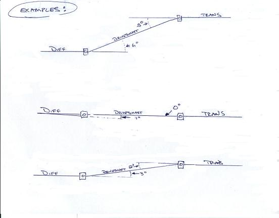

Get the driveline angle right. Pinion down 2-5*.

using a more "up" pinion angle loads the tires less.
the fastest radial tired cars in the country use less pinion angle and a timing computer to help retard the timing vs. time to limit power out of the hole.

if it is only about the relation of the angles, and if there were no deflection to "compensate for", then a positive angle as long as the relationships were maintained shouldnt be a problem right?
for example if it is all about relationship of the driveline angles then a positive would be just fine as long as the reciprical angles allowed it?
using your example but inverted, if it is only about relation then it shouldnt matter if we go positive instead of negative right?

And yes, you’re right, pinion angle is actually just the difference between the front and rear angles, not the difference between the pinion yolk and DS, which is just about meaningless but seems to be the only thing most of the f-body world cares about.
FWIW, your middle and possibly the top example would kill U-joints

so other than deflection there is no reason what so ever to run a neg pinion angle?

No I haven’t, since unlike you seem to believe I’m not stalking you to pick on you and generally don’t spend much time on the suspension board here......

What comments? That those 2 examples will damage the U-joints? Close to 0* will not allow the needle bearings in the caps to move enough and they’ll all wear at one point wearing the thing out quickly, and 6* is outside of the normal range that you’d want to run a u-joint if you can avoid it (which is why I said possibly on that one)…
