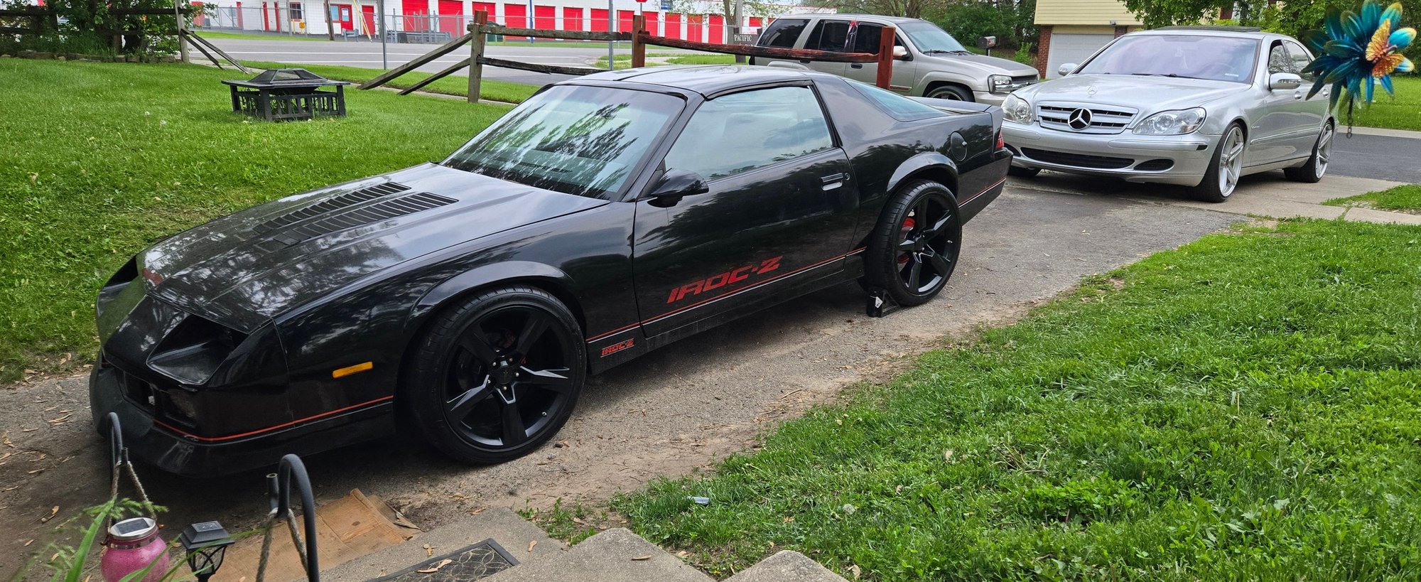

my backs fit fine with 275/35s and a 20x9.5 wheel but the fronts hit the fender immediately when I turn the wheel on the back side closest to the door . Im running 245/40s on the front with a 8.5inch wheel 2 inch adapters all the way around. Any idea what i need to do in the front other than cutting anything? Would a 1.5 inch adapters up front help?Originally Posted by Buggy Disaster

Any idea what i need to do in the front other than cutting anything? Junior Member
Quote:
well i just figured they'd look good .they are camaro rims at the end of the day and other people are running them in this size but after doing exactly what others say they've done it definitely doesn't work for my car in the front anyway. If I had 18 inch iroc rims id gladly put those on but this is what i have and can't really afford to just go buy another set right now.Originally Posted by T.L.
Get the proper-size wheels & tires... QwkTrip

Tall tires
Lowered suspension
Wheel sticking out too far
All these things work against your ability to turn the front wheels. You got all three going on at the same time.
Lowered suspension
That front tire is almost 28 inches tall. Most of us have 25-26 inch tall tires. My 275/35-18 fronts actually measure 25.5 tall. Soooo, I'd either cut out your fenders/wheel wells to make more room or get a smaller tire/wheel. Both will work. One makes more sense than the other though.

stock height, i guess 40 series could be kinda too big ,but im gonna try to bring the wheel in with a 1.5inch adapter instead of the 2 inch that was recommended by hawks.Originally Posted by QwkTrip
Tall tiresLowered suspension
Quote:
definitely not cutting anything on the car, I'm gonna try smaller adapters and bring it in a half inch if that doesn't work at all then I'll just sell the rims and tires im not doing all kinds of stuff just to make them fit its just dumb at this point tbh..Originally Posted by Firechicken82
That front tire is almost 28 inches tall. Most of us have 25-26 inch tall tires. My 275/35-18 fronts actually measure 25.5 tall. Soooo, I'd either cut out your fenders/wheel wells to make more room or get a smaller tire/wheel. Both will work. One makes more sense than the other though. QwkTrip

Forum member Zach/90\irocZ has been running taller 19 inch wheels and tires for many years of many sizes including 45 series. I'd search for posts by him.

Quote:
By that do you mean the vehicle still has original springs, or you have new springs advertised as stock replacement?Originally Posted by Danruffing
stock height. 40 year old original springs aren't stock height anymore. In your photo it appears that the front has drooped quite a lot. Stock spring rates also are far too soft to be having a tire out that far. People typically use 800 to 1100 lb/in spring rates when tires are located under the fender lip like that.

From here, it looks to me like you may need spacers/adapters that are closer to 1" thick. I don't think losing .5" is going to cut it.Originally Posted by Danruffing
stock height, i guess 40 series could be kinda too big ,but im gonna try to bring the wheel in with a 1.5inch adapter instead of the 2 inch that was recommended by hawks. Junior Member
yeah i mean I haven't changed them, the back sits pretty high and the front is lower than normal because my driveway is angled but the front definitely sits lower also there's a 350 in it not the original 305 im guessing weighs a little more however slight it might beOriginally Posted by QwkTrip
By that do you mean the vehicle still has original springs, or you have new springs advertised as stock replacement?40 year old original springs aren't stock height anymore. In your photo it appears that the front has drooped quite a lot. Stock spring rates also are far too soft to be having a tire out that far. People typically use 800 to 1100 lb/in spring rates when tires are located under the fender lip like that.
