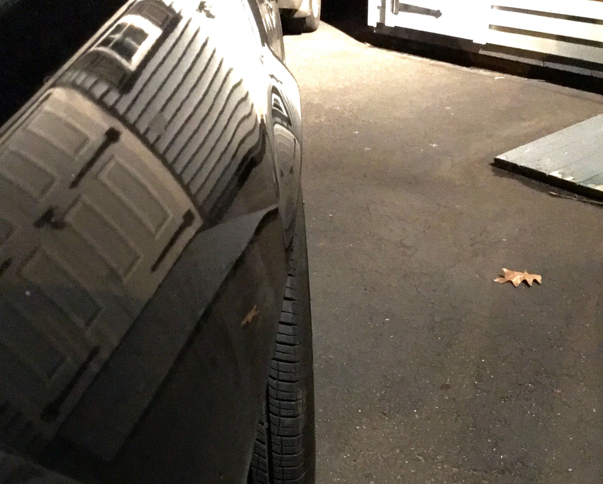

Apr 28, 2016 | 06:01 PM
Re: stock iroc rims on 4th gen rear end
Quote: EVERY fourth gen rear with 3rd gen wheels looks goofy/retarded. Every single one. You guys are insane and rationalizing your inability to install correct parts or go through the effort to swap parts over to a rear end housing that actually fits the car.
Consider this, not everybody has the limitless resources of time/money. I'm new to cars and I have been steered away from replacing gears by much more experienced people on here because it's not for novices. I'm also in college. I got 4th gen Firebird wheels for under $100, and a junkyard 2000 LS1 3.42 rear would run me close to the price of rear spacers alone. Considering my 87 drum rear with 2.73 gears with 180k miles needs to go, this is a good alternative to me.
I get where the opinion of it looking off comes from, but it's functional and an improvement, especially for beginners like me.
Reply 0

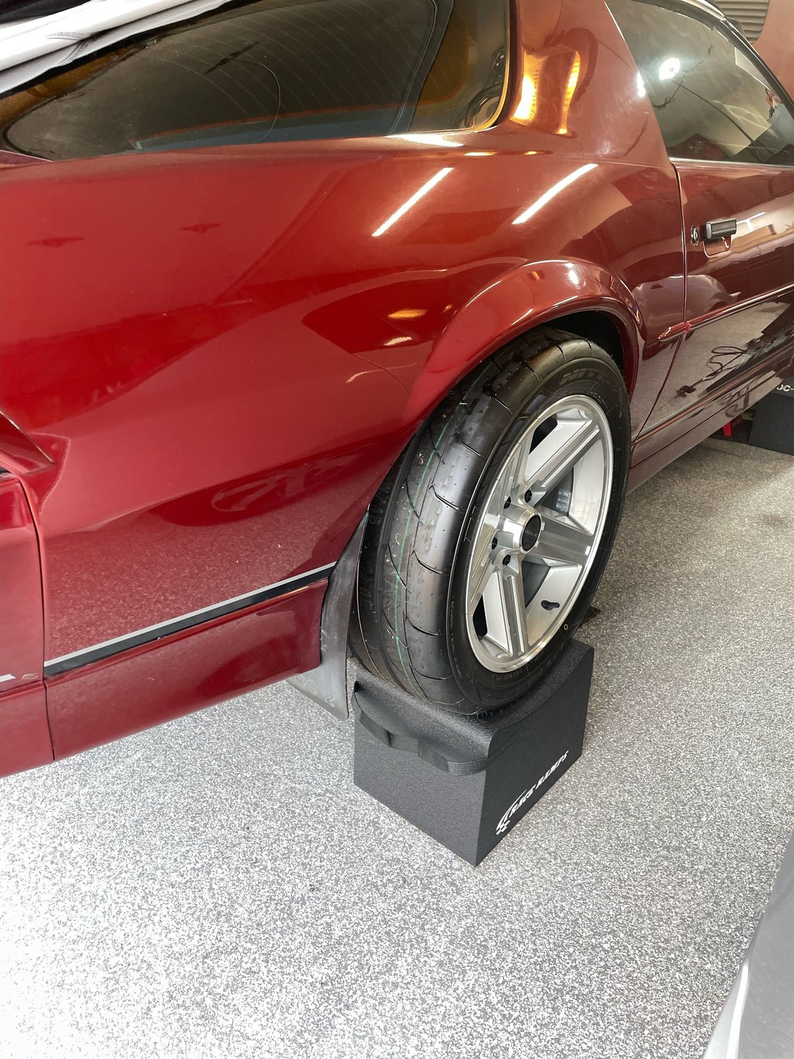

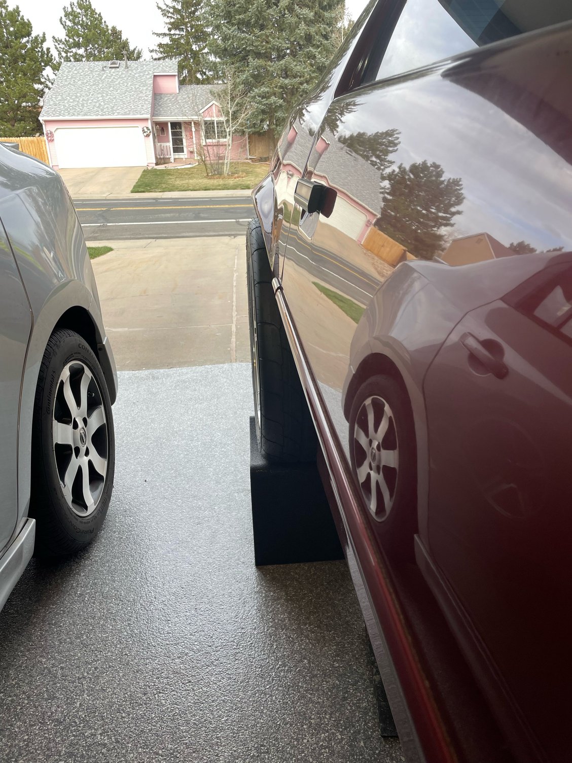

Jan 16, 2022 | 10:01 AM
Has anyone found a wheel combo that had the proper backspacing and offset for the stock front and fourth gen rear? I’m really wanting to not run spacers up front and have a nice set of wheels on the car that match front and rear.
Reply 0
Jan 22, 2022 | 01:19 PM
From what I recall it really depends on which 4thgen rear you swap in. A 93-97 rear is about inch or so wider per side which to me makes the car look awkward as the tires are flush or slightly poke past the fender flare. They also would rub on hard compression bumps which chewed up sidewalls since my car is lowered.Because i have an ls1 front brake conversion..my rear rims are mounted on the front with a small spacer,the rear has my front rims mounted without a spacer .Ive now switched to a S60 based on 3rdgen width and all is well where the wheels tuck in the fenders without rubbing.
98-02 ls1 rear I believe is the same or very slightly wider than a 3rdgen rear. There are tons of posts on here with exact measurements and what spacers are required depending on what wheel/tire combo you run.Biggest things to look at are what brakes you have front/rear,which rims you plan to use and factor in the backspacing needed to clear the calipers,how wide a tire are you trying to stuff.
