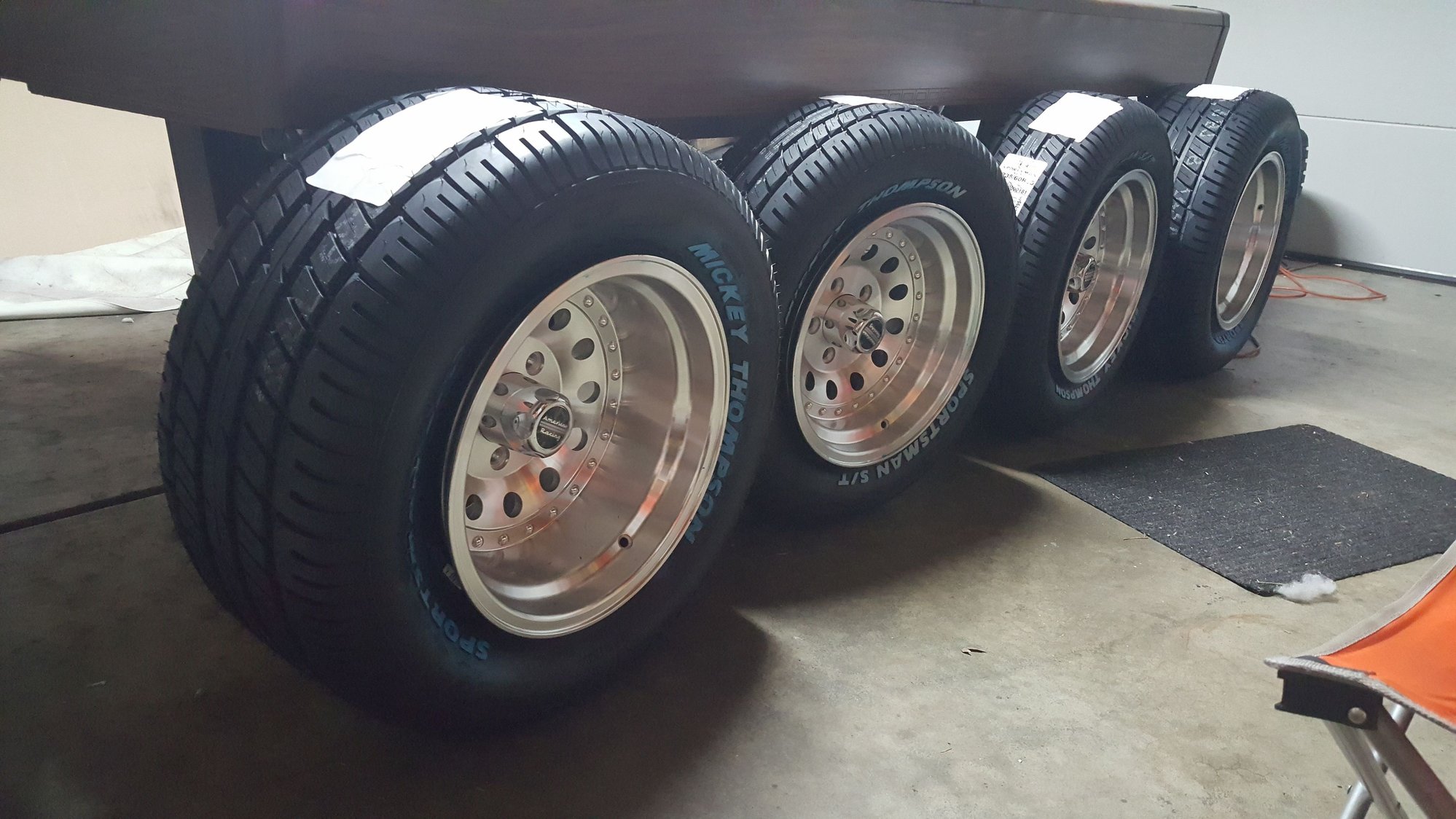

Ok, here they are. Love em

Before you mount them you might want to consider 7in wide in front and 8in wide rear.
That 10in wheel is going to kick out a long way.
Take a look at this thread.
= https://www.thirdgen.org/forums/whee...er-cobras.html
By the way, I also switched over to the M/T Sportsman S/T.
Love them for my DD.
I would not use anything larger than 255/60r15 rear today.
Once upon a time I tried to run the 295/50r15.
Way overkill.
Here's what they look like on 8in wide wheels with a 3.75 BS.
They stuck out about 1 1/2 in. Could not stand it so ditched them.

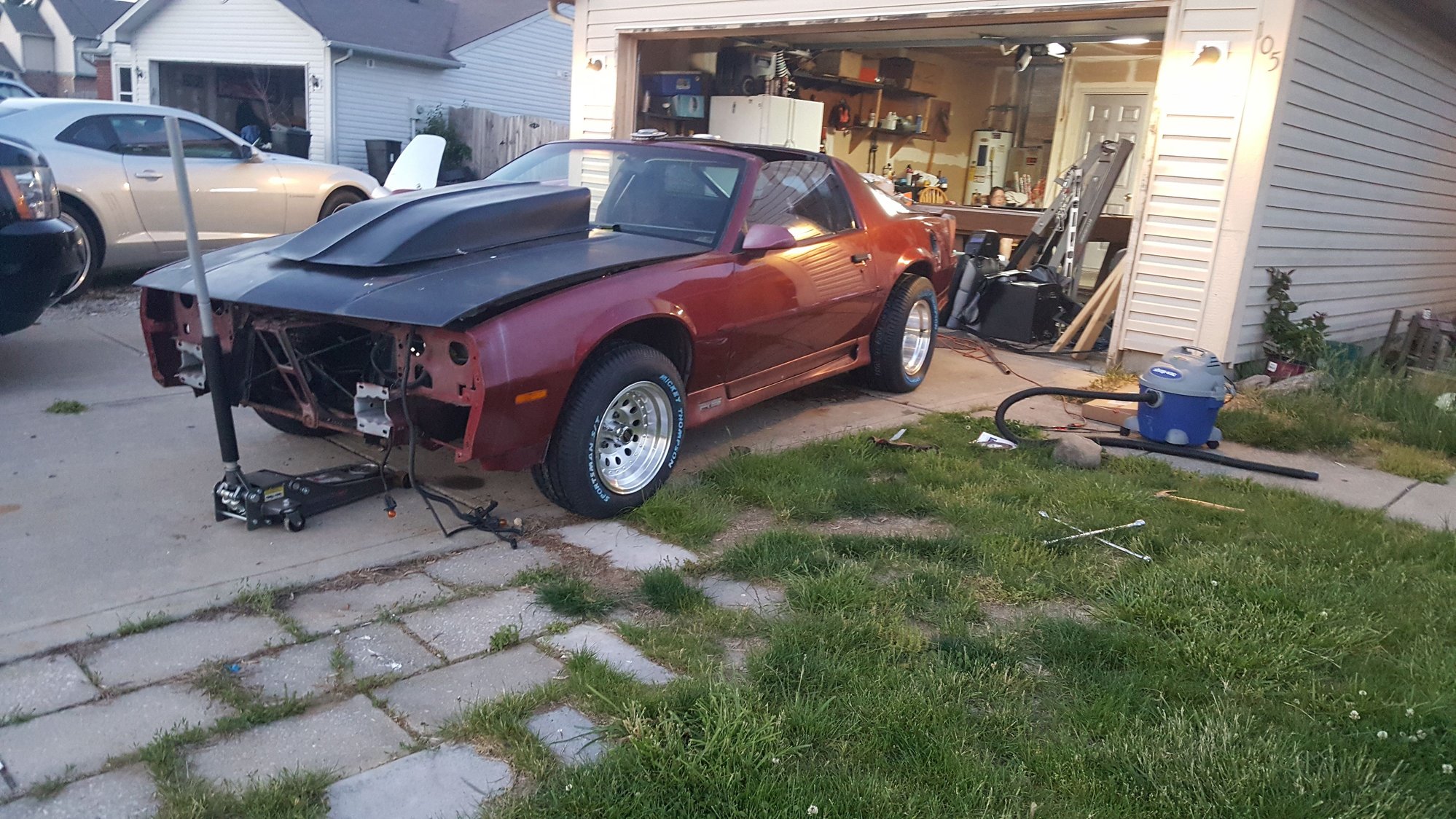

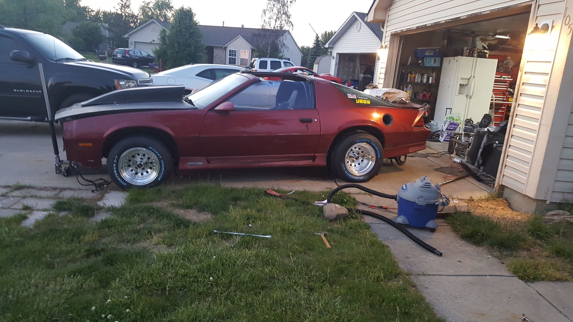

Ok, here they are. I'm extending the flares. And I know. Before anyone says anything, it will be ******* but after that, I'm adding yosamity Sam flaps.

Not as Rusty as I had imagined, Was thinking swiss cheese.. Saw your other thread in Fabrication, here's the link for other's to follow along your build, great foundation -- https://www.thirdgen.org/forums/fabr...-rs-build.html
