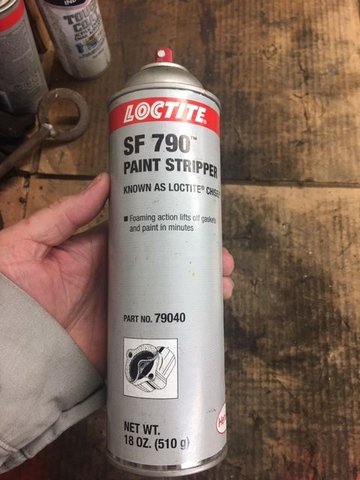

I used this on my Z28 wheels. It worked pretty good. You might have to spray it on a couple times but most of the clear wiped right off for me.

Thanks for the suggestion. I ended up using some brass wire wheels on my cordless drill along with the stripper and the combo of chemical and mechanical removal did the trick. I was quoted $50 per wheel to media blast. Took me less than an hour per wheel with my method, so not too bad.
