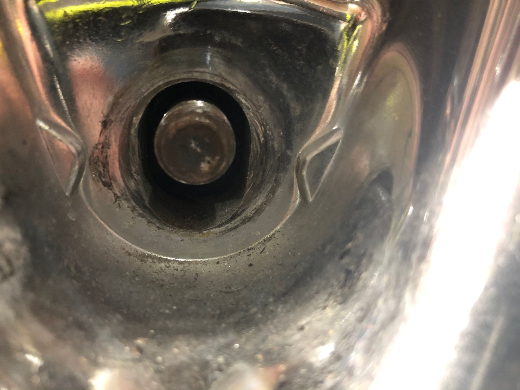

I did a quick test where I put my front wheel on the rear and removed the top lug to see how much distance there was between the top of the stud hole and the stud itself. Than did the same with the front. Here’s what I got.

I wouldn't make a cheap wheel with with oblong holes to be your gold standard.
The bolt pattern is 5 on 4.75" unless somebody has done something super stealthy to trick us all.

It's probably just measurement error. It's never going to come out to 4.75 on the dot.
82-2002 Camaros have a unique rear axle, not shared with any other car, with a mounting pad cast into the center section where the torque arm mounts. 100% of them rolled off the factory floor with 5 on 4.75" bolt pattern. No other axle from another car could possibly be swapped in without custom fabrication and welding on a plate-steel torque arm mount.
I applaud you for being careful though. If you want to settle your mind then cross-check the part number on those brakes in the picture and make sure it belongs to an 82 Camaro.

Since it had "universal" wheels with slots, I'm going to say the wheels studs are bent. Replace them all.

What axle is in the car? Have you pulled the drum to see if the axles are drilled for 2 patterns? Not sure why somebody would go through the effort to convert to 5x5

Axles are not drilled for two patterns and I’m not sure why the guy that built the car would’ve done 5x5 but than again, the guy also mounted the shocks upside down and didn’t know why it was hoping so much during burnout, launch and shifting lol

I want to see the axle and suspension on the OP's car, but you something is fugged up to make that axle fit.

If you zoom in the pictures, I see what looks like a ladder bar contraption in place of the lca. That would explain a lot.
Good catch, that would explain the issue

Car is a drag car. Not street legal. Ladder bars and coil over suspension. Mounts on top and bottom of the shocks are exactly the same.
