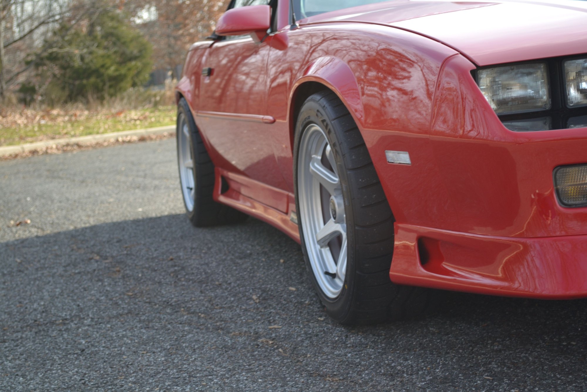

WHat wheels brand model is that in the picture?
