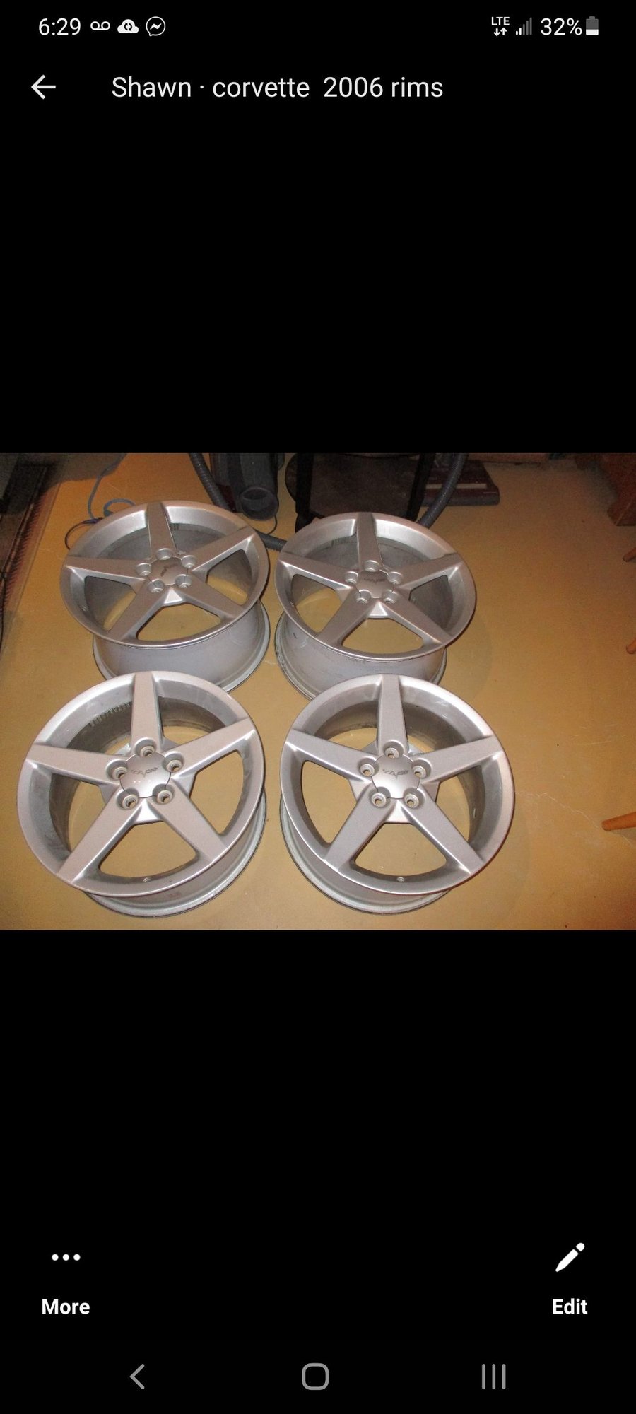

how is the fitment in the rear? I have an '86 Z28, I am waiting to get the staggered 5 spoke C6 wheels back from powder coat. I am going to be running with a quick performance 9" rear with the housing for a fourth gen. I didn't order the rear end like that. I bought it off a fellow Canadian who was nice enough to pay all the shipping, duties and brokerage fees lol.

Are they the standard C6 wheels or the Z06 wheels? Standard C6 rears will fit fine with your 4th gen spaced rear, albeit with a small (1.25" maybe) spacer.

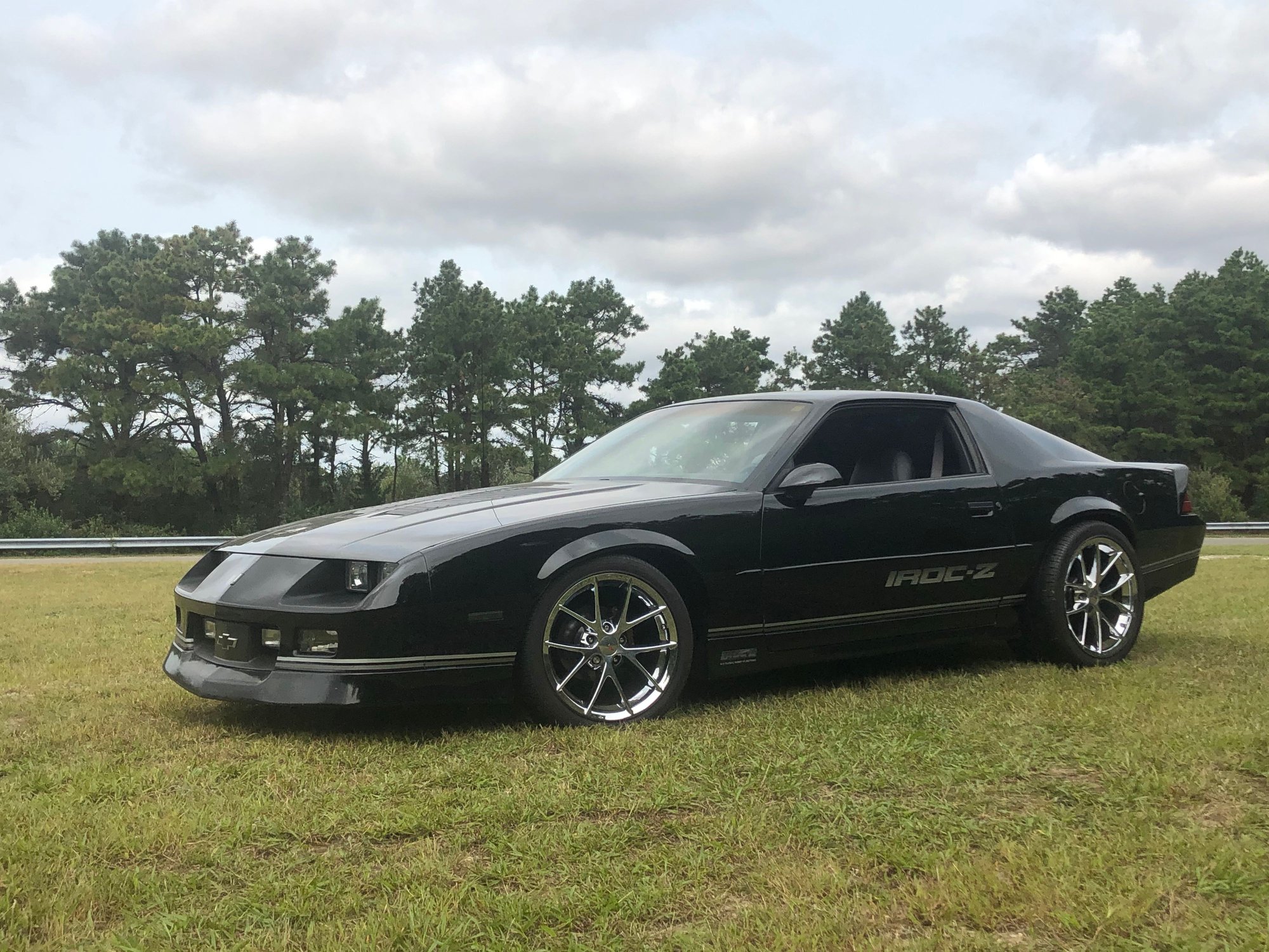

I had these on my car and they rubbed like crazy. I made it down the street to take these pics then they came off and were sold.

Both. It could be because I’m on Sportline springs to. Very low
