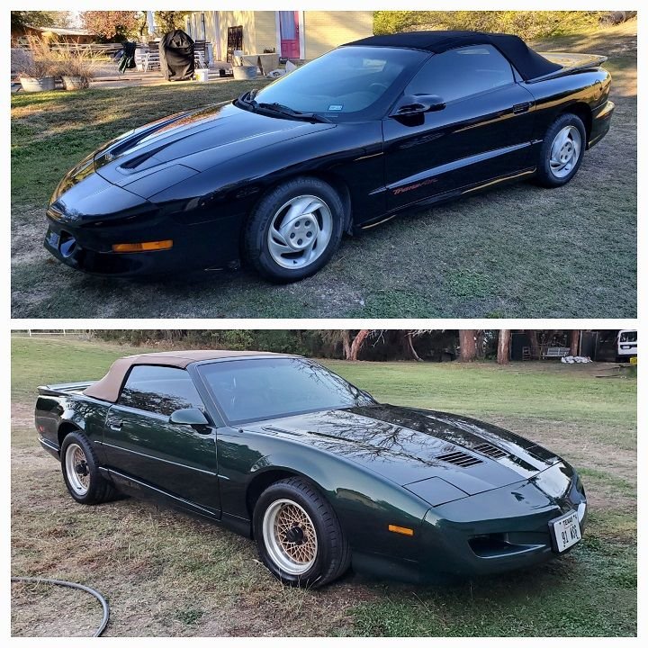

I run 245/50 ZR16 on both my 91 and 94 TAs, as it was the size delivered on the car from the factory.
Unfortunately for me, both sets of tires will "age out" before they wear out.
The BFGs that were on the 91 before I purchased it about 3 years ago look a little "meatier" than the Toyos that I just put on the 94.....but because they'll "age out," I'm kind of a stickler when it comes to the manufacturing date of the tires, and the Toyos were the only ones that were manufactured within 120 days of my purchase. Everything else was about 18 months old already.
