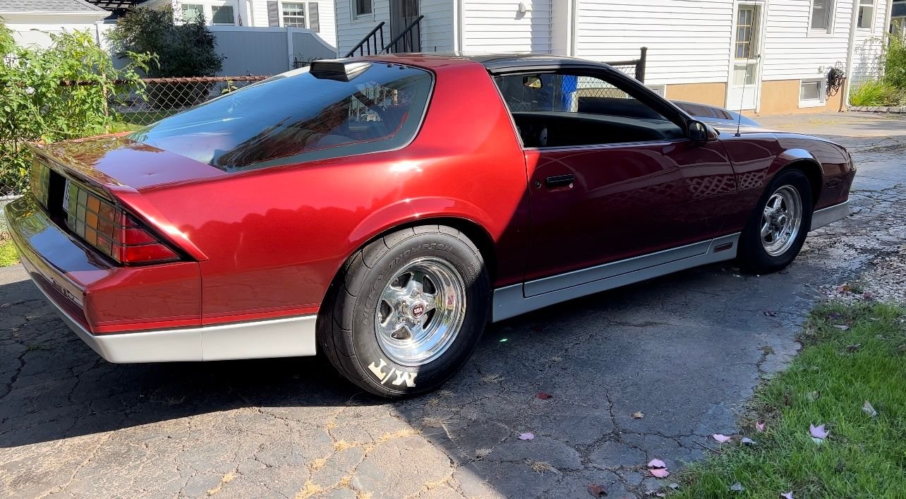

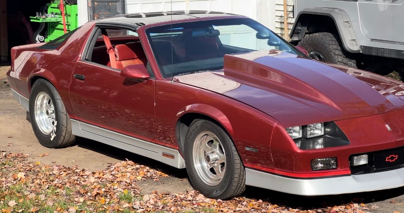

This is a Mickey Thompson 255/60/15 is measures 27.3” diameter and a section width of 10.1. The car is lowered 1.5” and on a 15x8 wheel with 4.5” backspacing. If you’re looking for a tire for a stock wheel this may not help at all. It’s has no rubbing and nothing has been trimmed or beaten with a hammer.
