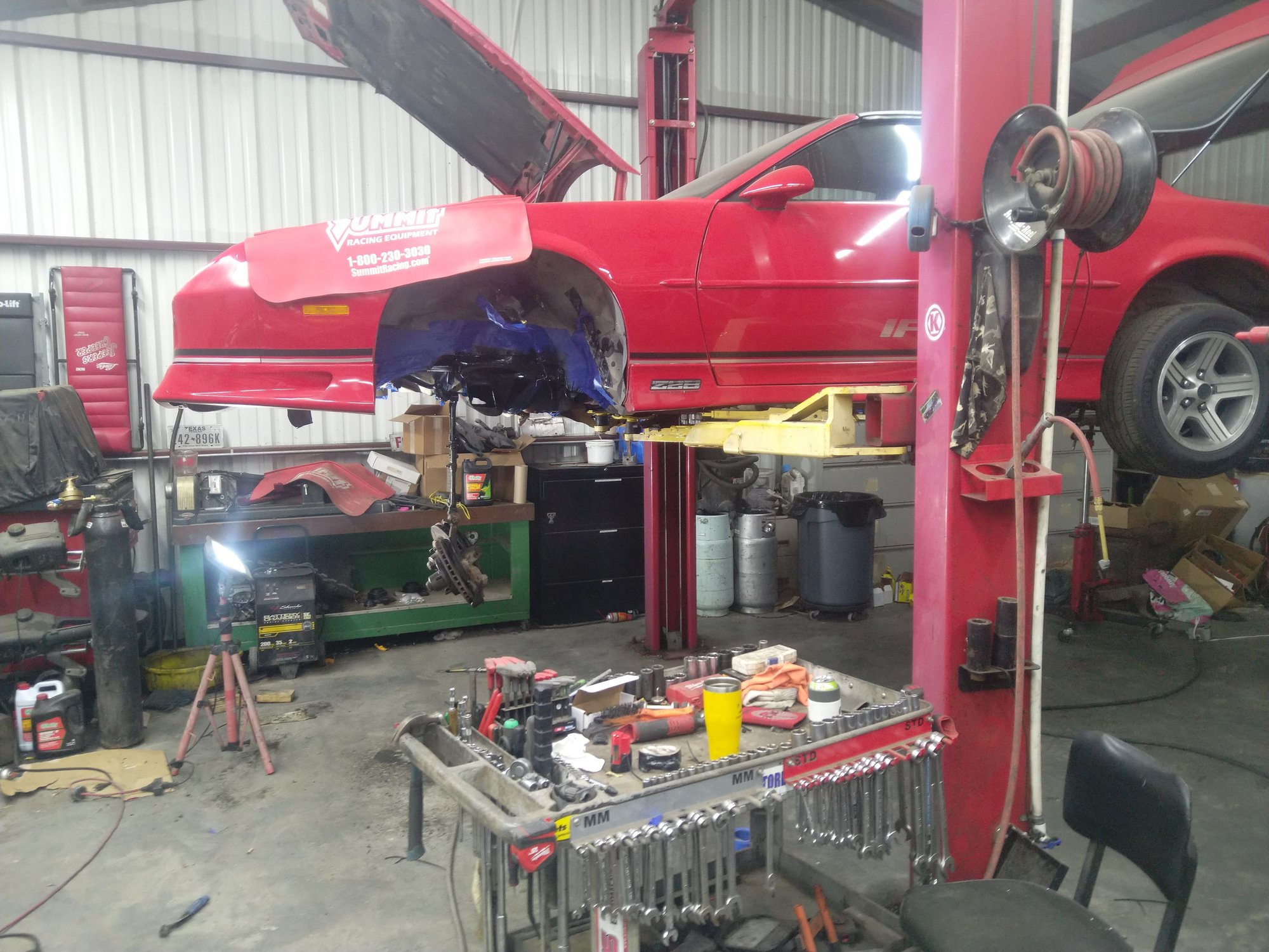

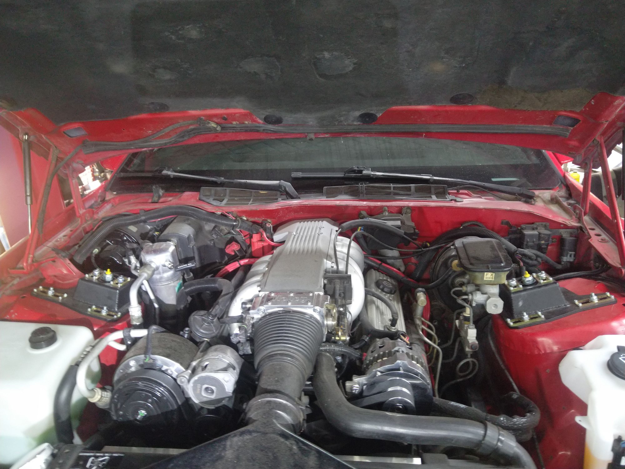

Been reading for a long time but since I always find the answer I'm after (thanks to you fine folks), I never post. Appreciate all the tech in here and all who contribute! I can't count the number of times it's helped while putting together this car.
Before you say "go search" I've read every thread on here and many on other sites about fitment of 9.5-10.5" wide 18" wheels on these cars. At least 12 hours of it. I also have an 87 that I ran front 18" (x8"?) IROC wheels on all the way around years ago, and hit the rear fender lip on bumps (275/40/18). Trying to avoid that but I dont want it to look tucked or like it skipped leg day either. Trying to find the happy medium so to say and go out as far as I can without hitting the outer fender lips.
I know every car is different, but only to a small extent. I'm about order wheels (Forgestar, Forgeline, or CCW) and am stuck on what BS to order. Seems +13mm aka 6" of BS (6.5" on a 10.5" wide) up front is the key to not hitting the strut and also not hitting the fender lip. The rear seems to be 6.5" BS aka 27mm, OR just the same as the front. Cant seem to find a solid answer and I dont want to order custom wheels twice. I could measure and do all this and that, but thatll never tell me if it'll hit when the suspension cycles. Most threads with pictures and solid info are for cars with 10.5" wide wheels. I am planning on 295/35/18s so a 10" wide is what I understand I need.
Car details that pertain to fitment: 1989 Iroc, yellow Konis, Eibach sportlines, Global west DelAlum bushings up front and their control arms out back, BMR panhard, Detroit speed strut towers, old Baer 13" brake kit up front (soon to have their 12" rear kit as well) and a stock 3rd gen 9 bolt axle. Car will be used for carving country highways and a track day from time to time. I don't mind using the BFH inside the fenders, but have no desire to roll the fender lips.
Seems many think the limits of backspacing is the mid to high 5s, but then I see folks doing 6 and 6.5". Some posts by @//<86TA>\ have been real real helpful but the more I read the more it seems I question my numbers. Ready to buy just need some clarification. Thanks!
PS, I'm a long time Master AC technician and am more than willing to trade wisdom/ info/ parts with anyone who takes the time to help me. Also willing to pay a shop to make sure these numbers are right, but don't know of any that do that. I'm in NE TX

Nice car. What rear end is in the car? Running 10.5 up front is going to be hard. Have you watched McLovin's videos on youtube? He goes by 3rd gen Camaro guy and he has a video where he shows what he did to make 18x10's work up front. I still don't know how folks do it. I am running a 9.5" wide up front with a 265 tire and rub at full lock. Ride height and alignment certainly come into play, but unless you are tracking the car, you don't need to go that wide up front. The pain doesn't offset the gains IMHO.

Thanks! I have a few hundred hours in it already. It has the stock 9 bolt rear axle. I do not plan to run 10.5s, just 10's. Goal is 295/35/18 all the way around. I will go watch his videos today, I appreciate the heads up! A little rub at full lock is fine, and we will be doing some leisurely track stuff from time to time. Otherwise it'll be a sunday cruiser and backroad killer.
