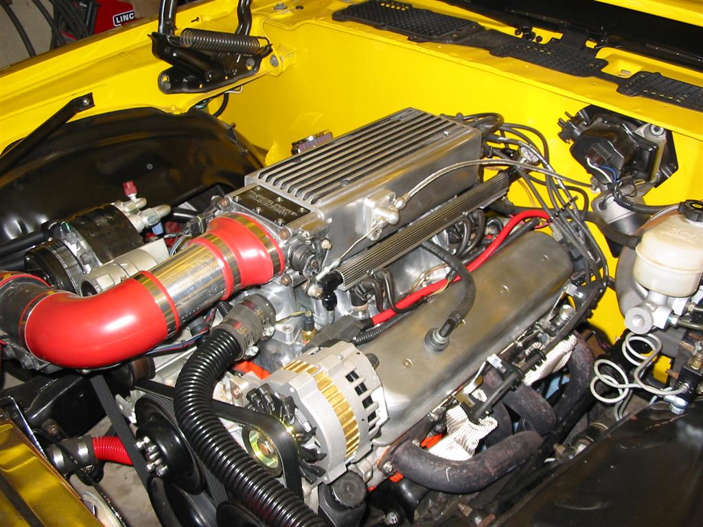

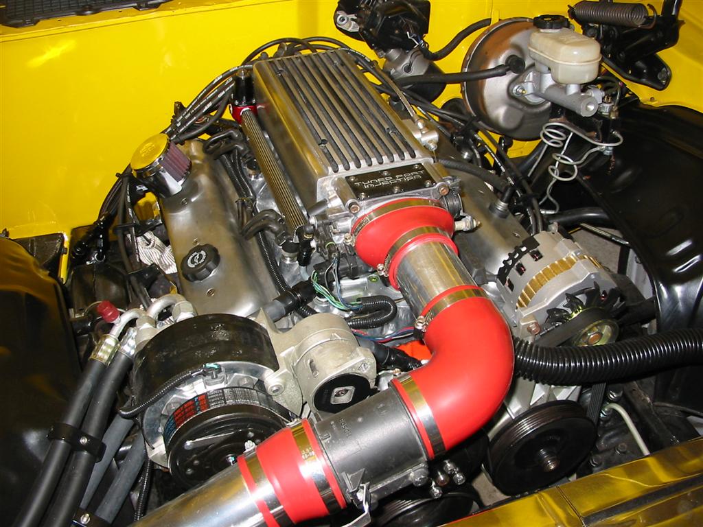

Re: lets see those HSR pics
Originally Posted by sailtexas186548
mine go from the stock hard lines, under the brake booster, behind the drivers head to the fuel rails
Same here:

IROCThe5.7L - That under hood picture of your car looks amazing! Wow.

Originally Posted by IROCThe5.7L
Same here:
IROC,
I see you are using the stock throttle bracket and linkage. How is the drivability with the cables being slightly offset? Do I see some sort of spacer in there to to better align it? Also I notices you retained the stock radiator hose and fashioned an adapter to go from 1-1/4" to 1-1/2". How was that achieved?
I figured why try to reinvent the wheel when you already have. Thanks for the pics.
It drives just fine. I just put some washers behind the bolts to make it as straight as possible.
The radiator hose I used was Advance Auto Parts P/N E71029. It has 1 1/2" water neck ID and 1 1/4" radiator ID. I had to a do a little cutting, and it didn't look like it was going to work. But it ended up working great. Here's a thread on it: https://www.thirdgen.org/forums/alte...wap-upper.html
