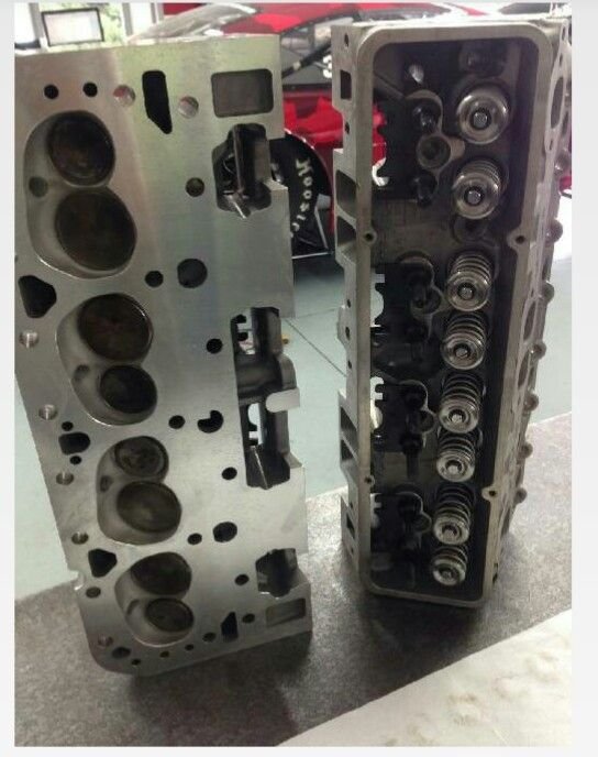

Heads are getting ported 5 angle valve job, bowl work etc. Edelbrock base is getting ported along with Superram. New 1.6 roller rockers, pushrods and springs. Think I'm gonna take the leap with the 280xfi. Worst case might need raise converter stall a bit more.

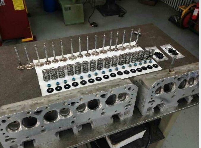

Heads are assembled after valve job, bowl work and new springs.

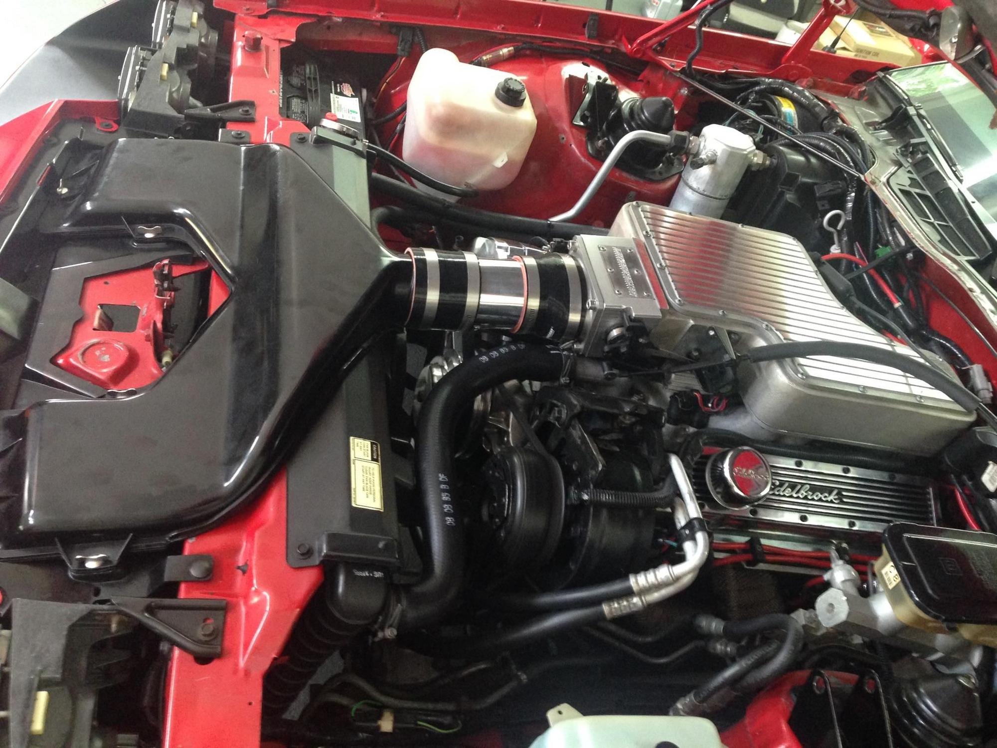

Finally got the car out to the track with the new 383 Superram. Ran 12.3 @113. Converter slip is pretty bad. Really losing a lot through it. By the 5th run I broke something in the tranny (something rattling around). Time for a new tranny and better converter. Getting tired of putting money in the IROC. I go out to the track with my 2013 CTS-V and rip off an 11.1@126 like I was sitting in a living room and nothing breaks or gives me problems. Love the IROC but it may be time to stop tracking it and just street cruise unless I want to drop a 12 bolt rear etc into it.

Btw, the 280xfi takes the unported Superram to peak power at 5900rpm. Most say it peaks at 5500. Guess a good cam makes a difference.
Old Nov 1, 2015 | 06:49 PM

Re: Cam for Superram
Yeah its gonna change the curve abit. Once tuned you'll need to play with shift points to find optimal times
Have any vids!? Hows the mid range power with that size cam and superram
So I can't believe it......that rattle noise wasn't the tranny. The brand new GM performance parts ZZ 383 lost a bearing and is rod knocking. Filter is full bearing material. Shop called GM parts and they will warranty the block plus the labor. I'm not having any luck with this car this year.......
