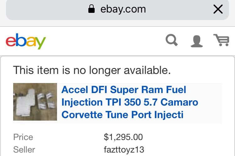

It seems people are asking around 1000 for them. I found one complete with nos plate and wiring harness and an accel computer for 650 which is why I’m debating. I just don’t know if it will be a big noticeable gain from where I am now. I actually do like the big tube runners a lot and the car does pull hard just not over 5200

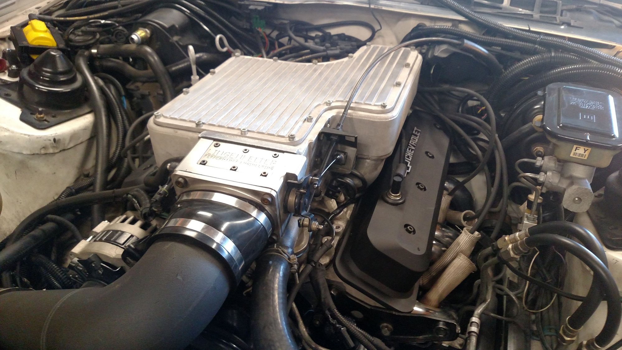

I love my SuperRam intake, except installing it or removing it. Lol. Mine is well modified and will build power well into the 6,000 rpm and up. I shift around 6,300. However it doesn't breath as good as the MiniRam above 6000 rpm. I've had both on with the same engine set up. The SuperRam builds noticably more mid-range power. I believe has far at total HP the MiniRam will win but for overall drivability the SuperRam wins specially with an automatic. My e.t. is 11.68@115.7 with the SuperRam and 11.75@115 with the MiniRam. Both intakes drive nice but the SR just has a better mid-range feel. I'm using the Dynamic FI ebl to run both intakes and I'll say the MR was much easier to tune. If you're still using the MAF system it should run ok with a good performance chip.
