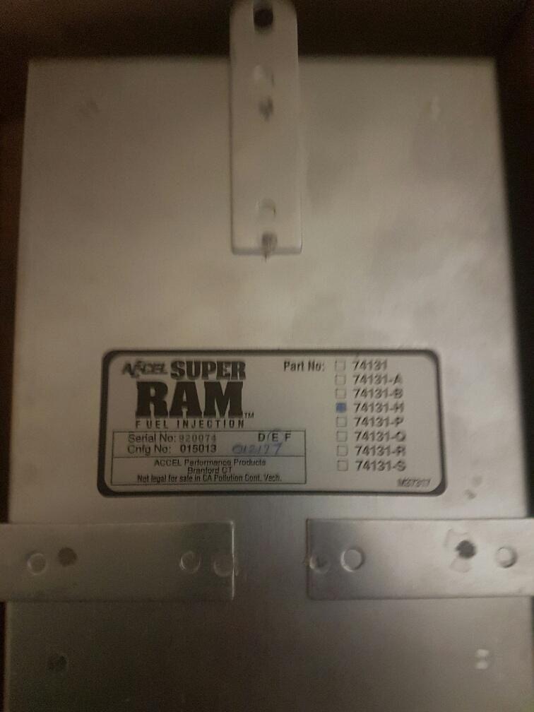

OK I made the decision to go SR (since there aren't any T-Rams that need a home) and there's parts like:
1) the bolt kit to hold this together
2) accel cable bracket
3) non Vortec heads
4) roller cam for this setup
5) injectors
6) Prom chip/tune
are several things I'm needing to even start the actual install so I'm gathering parts, looking for recommendations/advice
I just got the upper plenum and runners from a member here last night and didn't really look it over too well so I need to, it needs bead blasted and holes/threads inspected and repairs made where needed.
So anyone with SR experience please feel free to advise what worked for 1-6 above for you, share pics whatever I've done alot of engine work over the years but never a multi piece intake quite like this before, but I did put a TPI 350/700 in a 66 Nova SS I built in the 90's this 87 Trans Am of mine I bought in '91 and was newest car I had ever owned till last year the last few years it hasn't done much My son had it and cooked the engine and its been a slow road back to life so its coming back as my retirement car to build on.

this is quite a bit more complete - what do Yall know about the Accel ECM and harness? and 74134 H for ECM, my plan is S/R on a 383
this stuff is basically NOS

That’s old dos based junk.
should of come with a db9 cable for reprogramming
i think this is Accel gen 6
so thats worse then stock ECM and the chips? I mean I know so much has changed in ECMs since the 80's

It was setup to do a EFI install on a old muscle car. IMO, it's great for that and to have as a novelty item but not much else.
I would prefer stock ecm over the accels.
This should of come with a 3.5 disk
pretty old technology. You could repin the harness to 1227730.

Play a Game? GTW is a great game
this is going into my 1990 Formula that's 350 TPI now doesn't it have the 7730?
this also came with a large Bosch inline fuel pump and filter - I think I'd rather use stock in-tank pump
even throttle body was complete with new sensors and IAC valve

Your right your car does have a 730 ecm. I was thinking of selling the harness. Not to many new stand alone wiring harnesses for sale. You might have to add a few grounds. I just sold a similar ecm and could only get $15 bucks for it. It might be worth more with the disks and db9 cable just my two cents.

cables? did you say cables? I have more than I can think I'd ever need most of its for the Holley Prostrip Annihilator that came with SR
the cable may be there but I haven't seen any discs, whats the DB9 cable look like?
been trying to get a grasp on WTH this is all about

That looks old but very cool.
not sure if the db9 cable was male or female. It should have a special connector that hooks to the ecm harness and then to laptop. To furether learn about that ecm contact mark efiguy here on tgo. He’s seen it all
