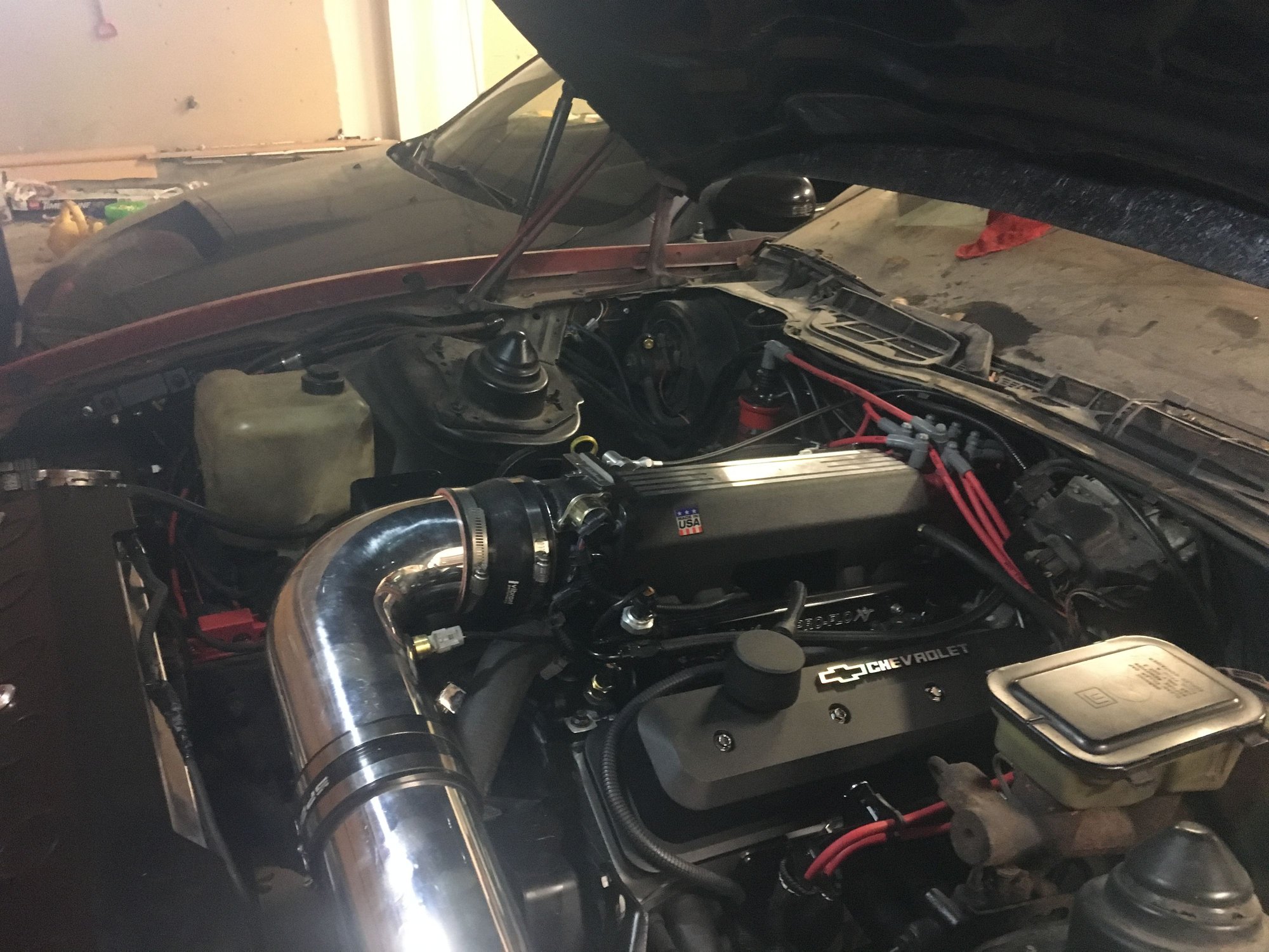

I have an xt in my 82 ta. It's a great system. A 305 will work fine w it. It's easy to set up and has worked really well. I had to notch the bracing on the hood over the throttle body. It should work fine just make sure it matches w your heads well.

I have poly engine mounts so it may sit up a little more than stock. The center of the hood support was clearanced for the throttle body. Thats the only place it was close. The drivetrain angle will play a roll in contact of this area.

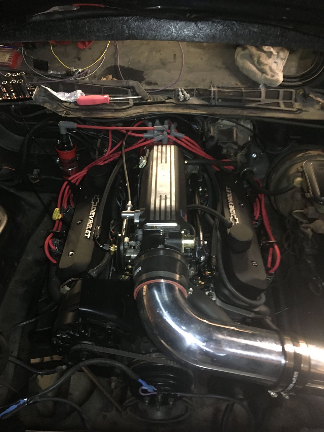

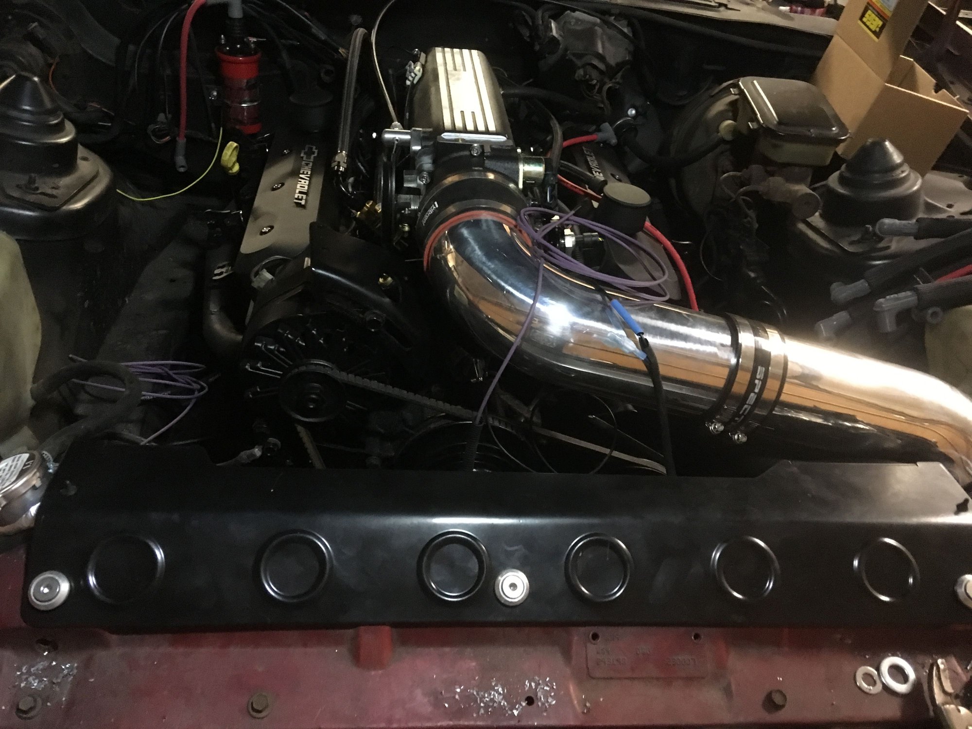

It rips. I had the pro flow 1 on it years ago and switched to the 4 in 2019. I have. 450hp setup/t56 and this winter it's getting a blower. The of PF4 works w boost.
it's really easy to setup. Runs great. I have 3 friends w pro flow setups and also are psyched w it.
if you have any questions about it let me know. These pics are from when it was working on it in 2019.
