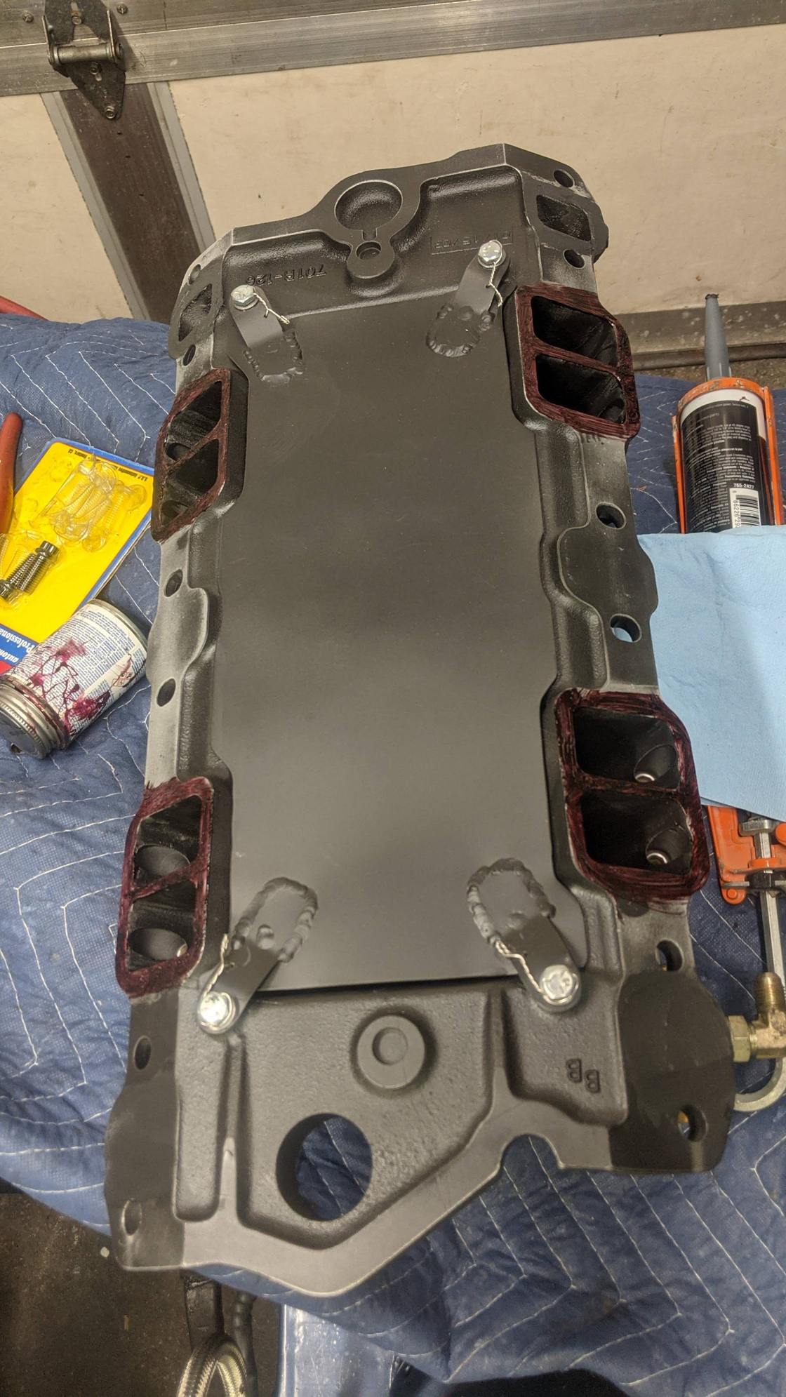

Thermal barrier paint and stainless steel heat shield:

That's a nice looking piece. Good work. I wonder if there is a meaningful temp diff above it?

Nice work.
