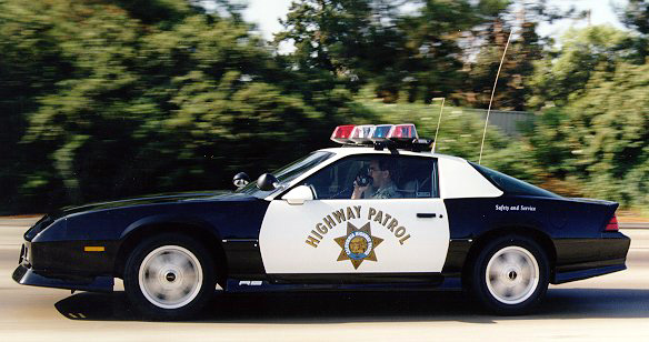

They were basically a Z28 with RS badging...you got the 305 TPI w/5 spd combo (230hp) or the 350 TPI w/ auto combo (245hp), 1LE brakes, air conditioning, and oil cooler.
