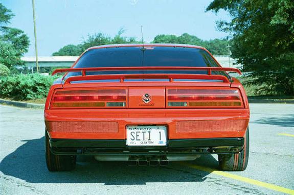

The problem I found with the testors was the fact that it dried a bit cloudy. It never became truely transparent like the VHT metal tint did. Duplicolor is making a metal tint as well. You might try theirs. In the pic LT1Guy posted above....the sun is shining directly at the light. So I am still getting a slight amber cast. I was really afraid to paint the outside though. I tried it on a test piece and it never came out right, plus with my lights already being painted body color. Taping off the camaro taillights should be much easier then the bird lights. You guys have straight lines to tape. Mine were curved and I was afraid I would really mess them up.
As far as sanding the testors paint. Its really testy (no pum intended) I painted a bunch of my engine accesories with that over a metallic silver, and finishing with duplicolor clear. Anytime I went back to fix something, say a part that did not get an even coverage, or got a chip, or scratched....it was a nightmare. I would sand it down, usually thru the clear to the candy. Then I would try to shoot over it again with the candy and the apint would crack really bad. I don't know why, but i would be very hesitant to sand the candy. I also found that if you paint a coat and wait to long before your second or thirs the same thing will happen.
Just totally follow the directions on the can. If they say apply the second coat w/in 15 min (not sure what it says) or wait 2 days before painting again, do it. Honestly I will probably switch over to the VHT and Duplicolor and leave the testors alone from now on. I don't think testors ever meant for it to be used on cars that are exposed to the elements. The paint chips very easy.
Anyway, as I ramble on. Page 19 on my site has more pics as I converted to all red, but here is a pic of them went he sun is not directly on them to show the difference

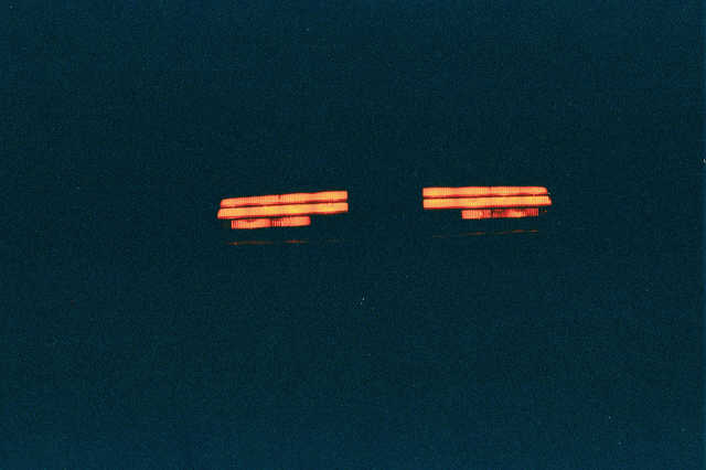

At night...
