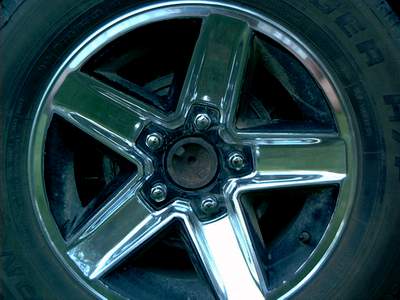

polishing the z28/88SC/RS rims are fun, unless you have the 91-92 style then it should be an easy job to do.Heres a link to a pic of one of mine
https://www.thirdgen.org/techbb2/att...postid=1128044

85sc those are some sweet rims on your car, what do you mean if i have the 91 style rims it will be harder to do? I have the same rims as dale and yourself on my 91rs but in grey instead of painted, is there a difference between yours and mine that would make them difficult to polish?

What I ment was the rims we have are hard as he!! to polish with professional tools or by hand, to me thats the fun part "doing something thats difficult." The 91-92 Z28/RS rims that are basically flat where as our rims are recessed which makes ours much harder to polish.

I see now, could you maybe post a thread with a few pics and a little step by step on how you did it to get that smooth look i would like to try this on my spare set of rims then if i think i did good enough do it to the good set, the foggy clear coat and grey paint just don't cut it anymore

I only have a few pics of the after polishing results. But heres one that I took after polisihing.
What kind of technique are you going to use?Hand polish or spend some $ to get die grinder,sanding rolls, da sander, da sander paper, polishing wheels, air compressor, polishing wheels and compounds.
Basically what I do is start out by using an auger to get rid of lip inbetween the outer ring of the rim and the ressed star part. And alos getting rid of the step between the top of the ressed star and the sides of the star.
Next I would use a da sander with 80 grit sand paper and get rid of any casting marks, and smooth everything out the best I can. Then go over the entire rim with 180, and 320 grit. Then I would use my die grinder with 120 to get all the tight spots and slicking the triangle inbetween the stars. THen I would go over the same spots with 400grit to finish off the hand prep work.
Next I would use my bench grinder with a sisal wheel with black grease to polish the rim to a dull shine. Then a sewn cloth wheel with tripoli grease to get a good shine in the alluminum and then using a loose buffing wheel with white grease to finish the rim off.
I dont ever polish anything by hand NEVER, it takes too long and you'll be luck if you can get the same results that I can with professional equiptment. Hopefully soon my polishing shop will be finished and I will be able to polish rims and about anything else for anyone.

Those look so sweet, i think i'll try one of my spare ones early this summer and if it goes well i'll do my good ones. if not i'll contact you, i'm not too far from arkansas when i'm at school. i already have a good compressor, die grinder and da sander, i was lookin in the eastwoods catalog and they have some polishing kits so now i know what you are talking about with the different buffing wheels and such, i just hope to see my car soon

Good luck, polishing is a hard technique to get right but when you do its just awesome to see what you can do. Especially when you polish a stainless oil pan and it looks like it has been chromed.

The thread is like 11 years old, but good to have a heads up. I doubt he did more than the one wheel anyhow. LOL I had ambitions of doing that to my spare set after I got my Irocs. Let me tell you, he wasn't joking about how labor intensive it is. I stopped at one wheel and traded the set to my body guy. He still to this day hasn't done the other three.
