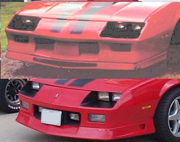

will this work? has anyone done this? i want to put the rocker panels and that piece under the nose on my 84 z28.. how much modding would be needed.

yes it will
this is my car its an 83 pretty much the same thing except it has the new gfx on it big difference

im not the one who put them on but!
but i here that all u have to do is drill a couple extra holes and that about it nuthing major
pretty much a direct bolt on.

You will need a new/used 85-92 front bumper, and you need to make 3 slits for the lower spoiler to attach to on the bottom front of the fenders. And you need to make 3 new holes for the rocker panels, 2 for the screws that go behind rocker panel emblem, and 1 hole for the rear part of the rocker panel. I love the looks of the 91-92 gfx's :hail:

Like someone had said you'll need an '85&up Z28/IROC nose for the lower piece to fit/look right.Also the rear ground effect is intergrated into the bumper cover,pieces behind the rear wheels are separate.

Here is a complete clone of a 1992 Z28...actually my old 84 before it was totaled. Came out VERY nice.....all the ground effects...nose...back bumper...and the highrise spoiler.

its not a complete bolt on...trust me. Me and crazy hawaiian traded body kits. To put the 91-92 on pre 91 Camaros you have to slightly cut the peice that the side skirts lay on. (the part under your door) you have to cut an angle at the ends of them. Then also you will have to drill a new holes for the outside parts of the skirts. As for the front bumper you will have to cut slits for the side of hte lip to hold to the fender. Other then that everything else bolts right up.

would it be possible at all to attach the front ground effects to my 84's nose? and how hard is it to put the spoiler on

The ground effect wouldn't line up or look good due to the section between the headlights comes more to a point on a 91-92Z than the flatter nose from an '84Z.

but i could for sure get an entire new nose with the GFX and it would bolt on very simply? and the rear bumper with the GFX is all one piece right
ps. in that pic are you talking about the spot under the license plate?
Yeah....well..I wouldn't say very simply....but..pretty simple...just a few modswould need to be done...and the back bumper...no problems at all..will bolt up fine....I mean..I done the whole thing...with few problems....
