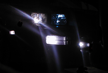

I found an old pic with all the front LED's on;
EDIT: I've actually been thinking about changing the side markers and turn signals to a really deep orange like on the 4th Gens and C5 Vettes except still use LED's; I know a lot will say "you've got r!ce, change them to the amber!", but I do sometimes like the "flashy"ness of the white, so for now it stays.
