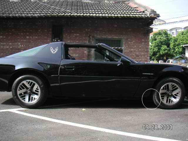

check the my rider, 235/40/18 in the front, 255/45/18 in the rear(oversize), sidewall of the front wheel is too thin, people said I can go 255/40/18 on my 8.5J rim but I like my rear wheel style .....

sorry, typing mistake, it should be 255/45/18 not 255/25/18.
when I putted 255/45/18 in the front, it rubs, I wanna grind the body part to fix it....

i could see how your set up would rub then...
do you have a two piece wheel? If so, what backspacing did you go with on your wheels?

they are BMW Rim, copy vision, not 2 piece, they are 18*8.5J 15MM offset, I use the information of SKULTE site to know the back spacing I am running, the backspacing is about 5.091, I should put a 3mm spacer in the front but I didn't, spacer will caused me more truble to put on the BMW rim on 3 gen.

hi Winderlicker, I got pics but they are big, so I need some time to reduce the size, I will post it after I finish.
For BeNnYbooPy, no need to machine the front wheel to get them fit.
The BMW rim request a custom center ring to fit on thirdgen, I got pic but the same problem above, some member had ask me before to post the pic and procedure but I am too lazy.....I should do it soon.
