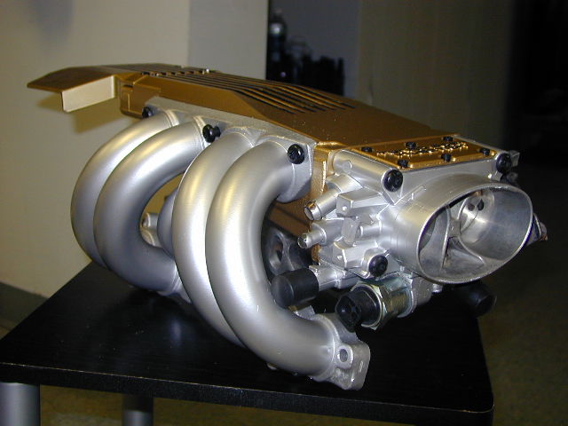

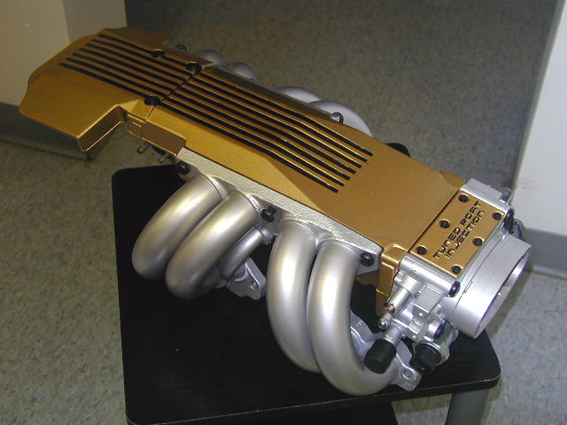

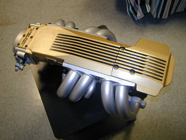

Here are a few pics of the TPI setup so far, The car is Black with the Gold package, this is the same color I'm using on the rims (they are pretty faded). I think I might do the valve covers in gold also..maybe the aluminum, not sure yet, I also did the fuel rails in gold with the black stripes to match the plenum, I'll have pics of that later...let me know what you guys think.....

It's Duplicolor Heat Engine paint (yep, rattle-can) about 6 coats on the aluminum and 6 color + clear on the gold, I used this on my last IROC and 3 years later it still looked great...thanx for the comments.

For the letters I just used a fine brush and gloss black, as for the plenum stripes after I painted it gold I masked it all off and used pinstripe to mask the lines I wanted to stay gold, then sprayed it with the black heat paint, then cleared all of it............even the clear is heat paint.
