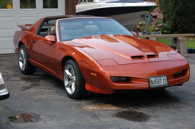

what did you guys do with your antennas? i wanna shave the antenna and relocate it but was wondering what you guys did.
here is a pic of that antenna ruining the epicness of the photo
