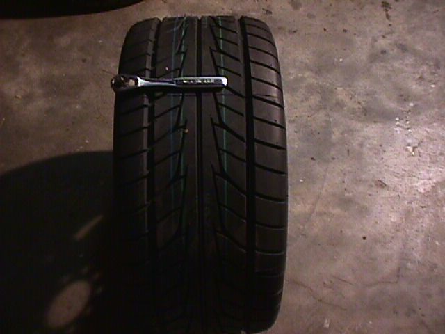

Here are some Nitto 555's that i have on my car. I like them a lot.
they are 275/40 and have a treadwear of 300
