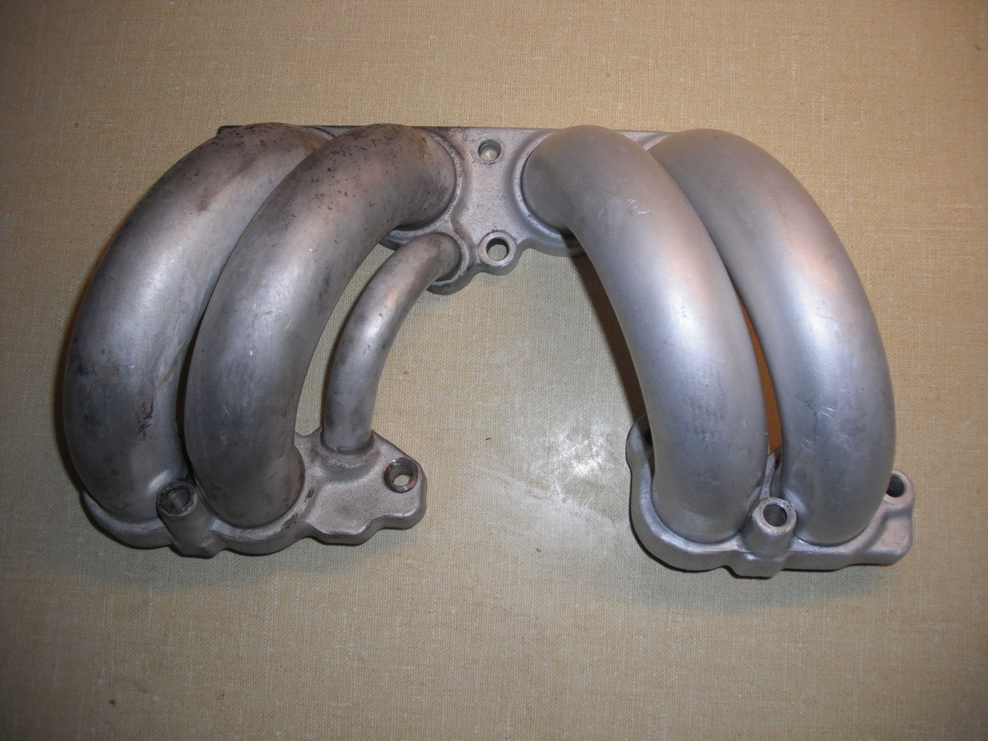

Thought I'd throw out an option here for those looking for another way to clean oxidized aluminum parts , intake manifolds, brackets, Runners, etc. Not recommended for polished or clear coated finishes. There is a product available called 'Kick' made by TRT. I purchased this locally at a store that specializes in automotive cleaning supplies and paint.
I've tried a few different ways to apply - the instructions say to dilute 1/1 with water - but I find it works best by using full strength applying with a clean cloth. Liberally dampen the cloth and wipe the oxidized area for a few seconds then use a paper towel to dry. Do this several times in stubborn areas that have a black oxidized spots. Be sure to wear gloves!! This stuff will take the scales off an alligator, lol. Do not leave the solution on too long , otherwise it will discolor the aluminum.
If you can't find locally, they are located in Venice, Florida www.msitrt.com . Not pitching their product - don't work or have relatives there. The stuff just works great and can certainly be an alternative to bead blasting.
Comparsion of treated and untreated

No chemical or solution can really take the place of a good bead blast but, to an extent, wheel acids do work well if you have the time and are careful about not to over do the application. Some parts though, like the exhaust manifold shields, they need to be media blasted.

Good to see it worked well. Make sure to give the parts a good rinse when done so that the acid becomes neutralized and doesn't stay in the metal.
