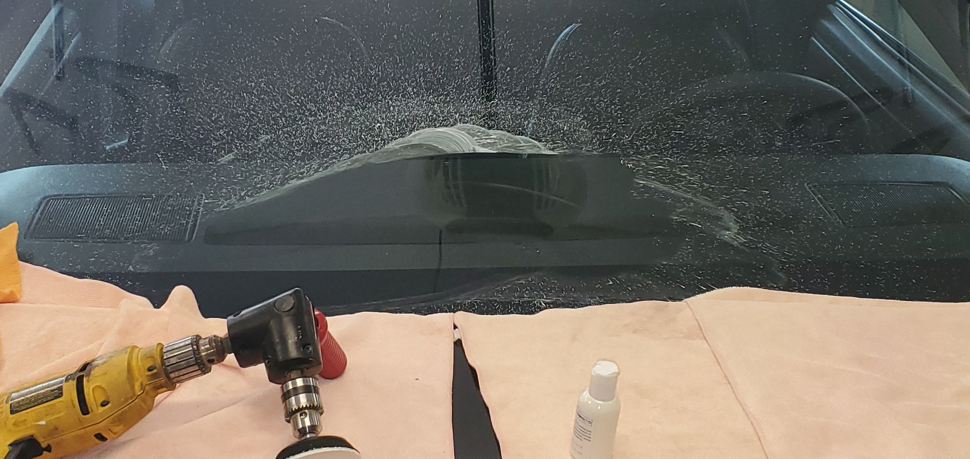

So I purchased my car back in the spring. My windsheild has a half moon shape scrape probably caused by debris under the wiper blade. The right side of the half moon is more noticeable and deeper.
I bought a glass repair/polish kit off Amazon and thought I would give it a try.
Pretty straightforward to use, the kit came with 2 polishing pads, an adapter for your drill and a bottle of polish. I used a right angle drill attachment to make life easier. Put a couple of dabs of polish on the pad and start polishing away. After a few minutes I did notice that the right side of the scratch did lighten up but not the left...so I kept on polishing, stopping every few minutes to wipe clean see progress and add more polish.
The polish splatters everywhere so if you are going to attempt this put down towels. After about an hour I had enough, the right side of scratch is significantly less noticable, the left side is still there but lighter.
So didn't get rid of the scratch but looks better than before. Spent $30 bucks for the kit.
