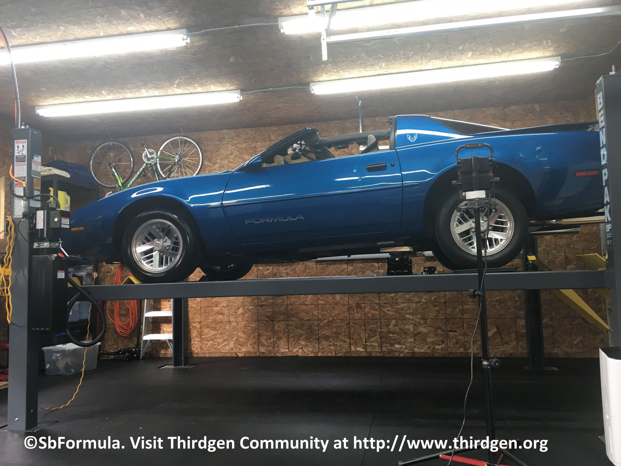

Nice hoist, every garage should have one!!
Thanks
