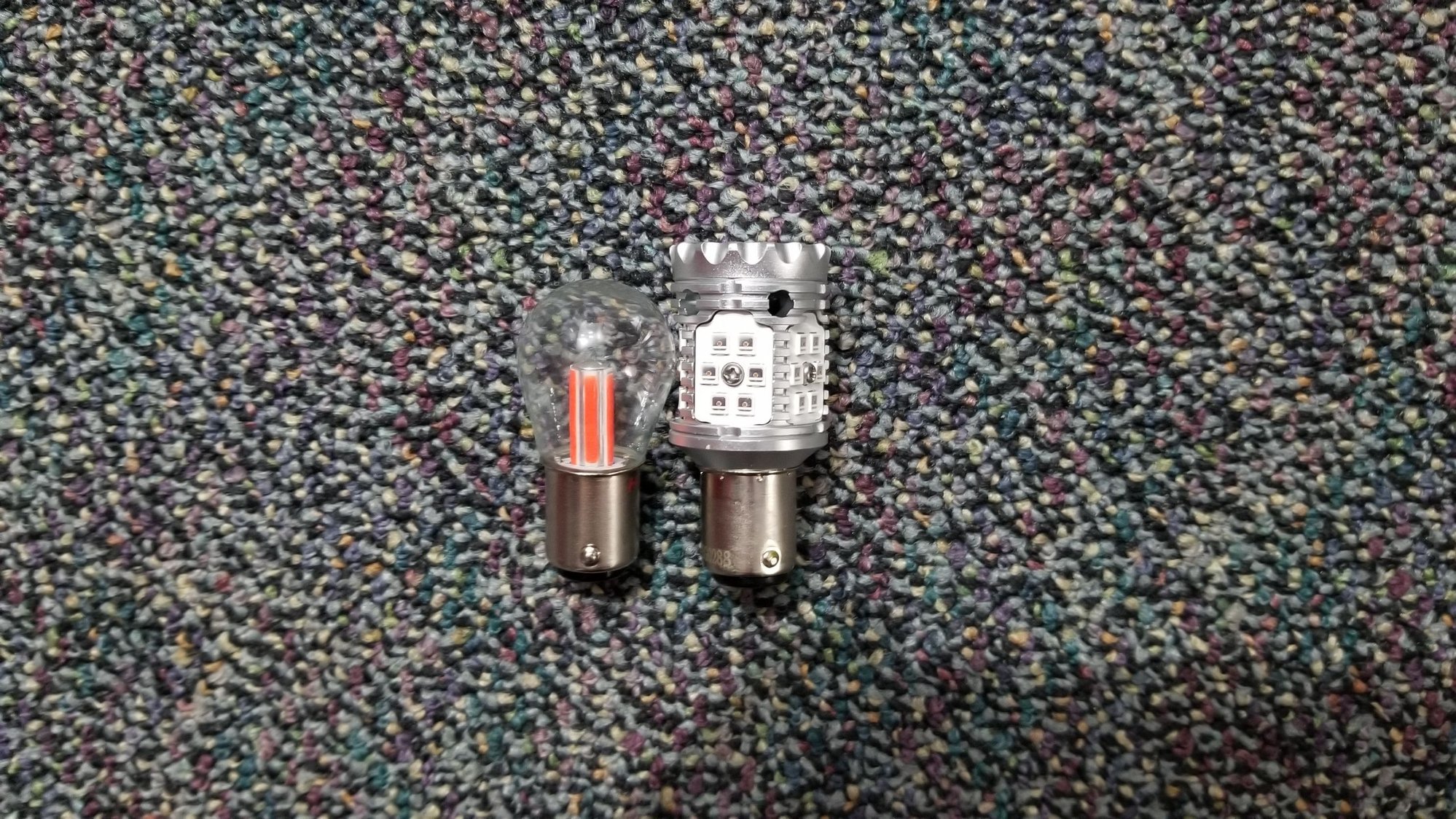

A lot of 1157/1156 LEDs, especially cheap ones, are wider than the base, and the body of the LED sits squarely on the base, so they won't fit far enough into the socket to twist them into place, as you noticed. They need to be tapered where they meet the base.
Holley Retrobright LEDs are designed like standard incandescent style bulbs, and they're not expensive. Here's one pictured below, next to a larger, expensive, resistorless LED that is tapered where it meets the base and fits properly because of that taper. If that larger one was square where it met the base, then it wouldn't fit far enough into the socket. 1156 sockets are even tighter, so a taper is even more important for 1156 LEDs
