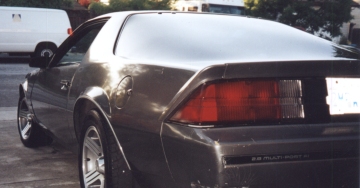

Here mine with the non-grid style. I added some smoke on top to blacken all the lights out some.
Attached Thumbnails What can I do to make my Camaro's taillights look better?-closebackleft2.jpg
