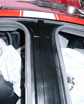

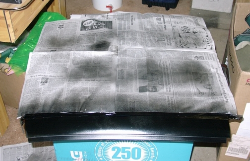

some of you might know i got my car painted b4 i put it away for the winter, but the guys never painted my black trimming and it needed it real bad... spots all over it of bare metal. so today i took it out and started it. first i took my t tops off and brought them in my basement and stripped all the paint off, took me about 15 mins w/ a metal pad and some paint thinner. then sprayed a couple coats of bulldog adhesion promoter on, let that dry then 3 coats of black paint made for cars, forget what its called. heres pics of what im talking about. sorry i forgot to take before pictures, but it looks nice i think, they are nice and shiney... you can see in the first one the reflection of the paper

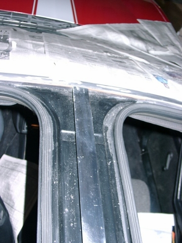

then i went in the garage and had my brother help me tape off my car and strip the paint off the middle part of the t tops, and smooth out around the edges with sand paper.
here is a close up of the bare metal in the center part of the t tops
and attached is another view. ill keep you guys updated as i move along .. most likely will continue it tommorow unless it rains like im told it will

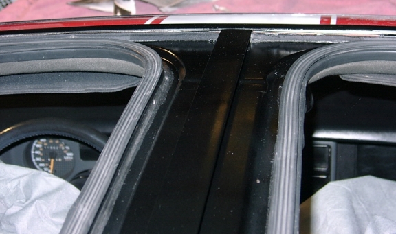

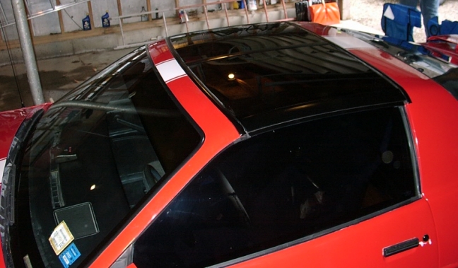

okay turns out my mom took the digi camara to work w/ her.. phew. she woulda been pissed @ me if i lost it. okay here are the finished pics
as you can see i had a little trouble w/ my lock on the third pic, the paper wont come off! im just going to take rubbing alchol to it
what you guys think?
