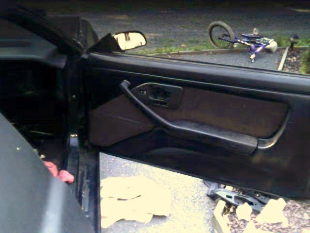

Here's some pics of my formally gray interior.
Attached Thumbnails Changing interior colors-4th-gen-console-1

Attached Thumbnails Changing interior colors-gta-door-panel-pass
