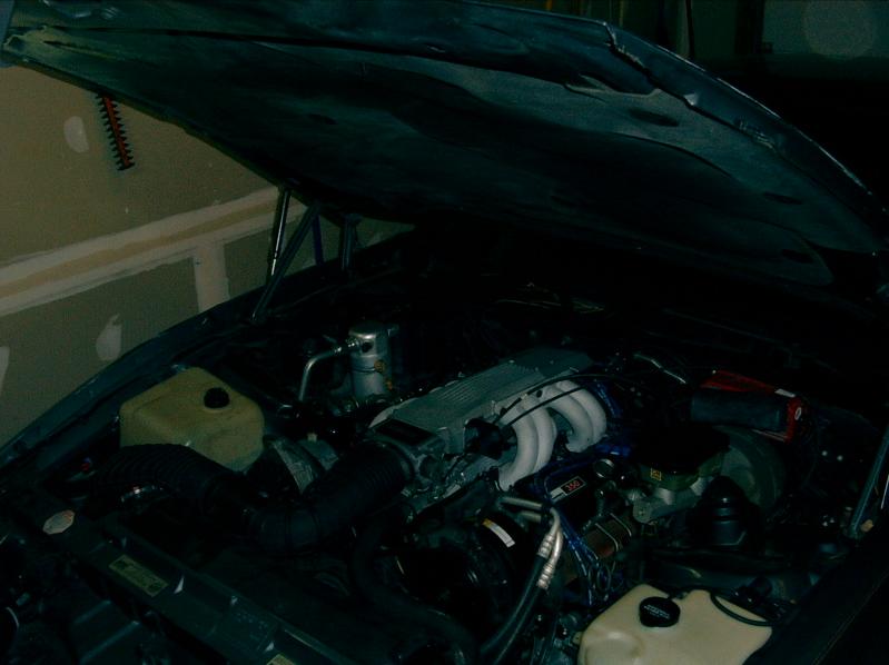

Old Dec 27, 2002 | 11:30 PM
BruceEmbry's Avatar
Joined: Nov 2002
Posts: 507
From: Triangle NC
Car: 82 Ponitac Firebird
Transmission: 4L60e/TCI TCU
Hi Everyone Again,
Attached is picture of my 82Firebird's engine carpartment.
See how clean it is!. Yes that 350 Tune Port Fual Injected monster. All Orginal new GM Parts were use when I had it put in less then 5 years ago.
