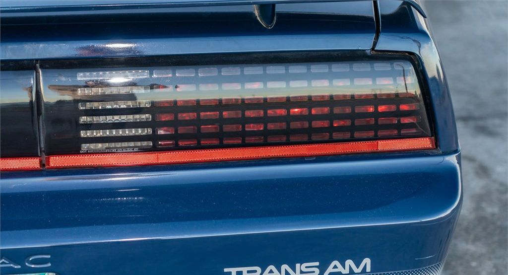

I want to clarify that I meant the 85-90 Trans Am tail lights with the grid pattern bezels.
Currently, the 82 tail lights give the car a Knight Rider look. Should I keep them, or replace them with these pictured below?
1985-1990 Trans Am tail lights.
Old Oct 9, 2024 | 07:50 PM
LAFireboyd's Avatar
Joined: Jan 2004
Posts: 2,947
Likes: 368
From: Las Vegas
Axle/Gears: 9-bolt/3.45
Re: tail light swap..91 bird to earlier trans/gta ????
Yes, those. They'll fit. 82-84, 85-90 and 91-92 will all fit. But whether you "should" make the swap is up to you, not us.
Since somebody has already changed yours to the 82-84 style, then wiring modifications that might've been required have already been done, so all you'll have to do is swap the taillight housings and plug-n-play.
