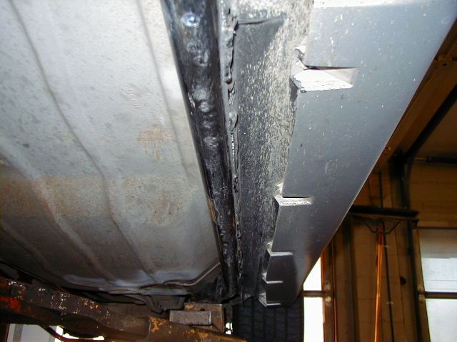

I don't have any full length shots, but I'll give you what I've got.

Another...I don't have a pic of them before they were installed unfortunately. I can't believe the difference though. They fit perfectly. I got them today and installed them right away. Actually, I took it to a local place where a guy named John worked on it who is a fantastic welder. For anyone needing welding in the Chicago area....hes the guy.

did he pull up your carpeting and all that such on the interior? Somewhere I read that you have to do that when you weld them. Or is that just like a good measure thing when in reality you really don't have to...?
Old May 7, 2003 | 10:57 PM
BTS88IROC's Avatar
Posts: 957
From: Mesa, AZ
I'd say you need to lift up the carpet when welding them, why chance getting your carpet caught on fire. You could probably get away with not pulling up the carpet, but I'm sure you could get them welded faster if you don't have to worry about catching your carpet on fire. Why risk it??

I got the same SFC's.
I just havent had them installed yet. I wanted to see how you had yours done. werent you suppose to weld along the rocker panel too? It looks like your drivers side is not all the way up against it..
Man! I want get mine installed.

The guy that did mine asked me what I wanted done. He said he usually throws water on the carpet or can pull it up. Since I don't care about the carpet at all(getting replaced next spring), the water was fine for me. He also pulled the lower part of the passenger side wheel well to make sure the weld went well. He even commented on the fit being excellent from the Hotchkis SFCs. No it isn't touching up there. I got these for a steal and after installing them would have paid full retail for the difference.

I think someone wanted pix of my SSM's
Right Side
Old May 20, 2003 | 11:36 AM
  #49
okfoz's Avatar
Posts: 14,298
Likes: 197
Engine: 5.1L TPI, 5.0L TPI
Transmission: 700R4, M5
And the left side:
Keep in mind I had to powder coat (paint) them myself...
John
Old May 20, 2003 | 01:37 PM
  #50
Spdfrk1990's Avatar
Joined: Apr 2002
Posts: 2,972
From: Cincinnati
hmm it almost looks like ur exhaust is touching about as much interference as i have. Did u just lower the y pipe a lil i think if i did that though it would be 2 low.ur pass side sfc looks like it goes up closer to the floor than mine.
