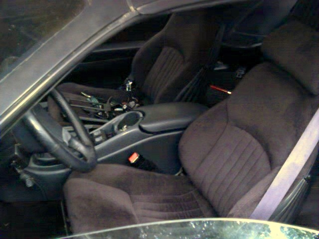

In a Bird it's easy as pie, bolt in and go--in a Maro a little more involved but still easy. Just make sure you get one from a stick--autos won't work.
Attached Thumbnails How hard is it to put in a 4th gen console?-4th-gen-console-2

The auto console from a 4th gen has the shifter 3" off from a third gen. That is why you will need to use an manual console.
